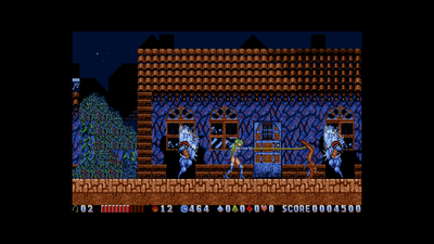

PS - at least on my settings i'm not getting this mess https://www.gog.com/upload/forum/2015/05/98be … 6b60a07f2cc.jpg

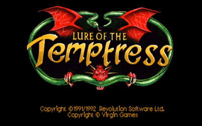

Here is "Lure of the Tempress" displays in the modified DOSBox in fullscreen with pixel-perfect aspect-ratio correction.
EDIT: the image was corrupted by the hosting. Uploading.
Your example has the source pixels scaled 4 pixels wide and 5 pixels high, scaled pixel aspect ratio 1.25, scaled resolution 1280x1000.
The ideal would be to scale 5 pixels wide and 6 pixels high, scaled pixel aspect ratio 1.2, scaled resolution 1600x1200.
Of course the ideal scaling won't fit on your display, so you are trading some accuracy in the aspect ratio for "perfectly blocky" scaling. How much will you allow the aspect ratio to be off (the tolerance) when deciding on the scaling factors for other combinations of source and display resolutions?
Reply 28 of 733, by Ant_222
That's right.
I see three possibilities here: a) find the best approximation that the resolution allows (may result in small magnification factors), b) magnify one side to the maximum and the other to the best scale possible (may result in suboptimal dispalyed aspect ratios), and c) find a compromise between magnification and aspect-ratio error. I can easily implement all three, but my first version will have c). Other progammers (or I later) may improve it, add their own algorithms, or manual control over vertical and horizontal scaling.
