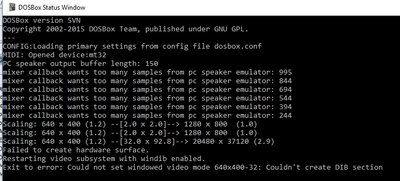

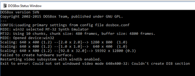

Knight of Xentar crash in windowed mode, here is console log
I failed to reproduce the problem. With what config settings did you start the game and what did you do for it to crash? I see three lines reporting different scaling lines in your log screenshot, the last one being wrong.

Reply 274 of 733, by KainXVIII
Still same error with latest version of Dosbox SVN in Knights of Xentar
Some dosbox.conf settings that i use
fullscreen=true fulldouble=false fullresolution=desktop windowresolution=original output=surfacepp autolock=true sensitivity=100 […]

Reply 276 of 733, by KainXVIII
Ant_222 wrote:
Does it appear right after you launch the game?
Only after i switch to windowed mode (alt+enter)
Reply 277 of 733, by Ant_222
Since I still can't reproduce the error will you please tell me whether you enter the pass code and start the game before switching to windowed mode? Does the error remain with
windowresolution=desktop
Reply 278 of 733, by Ant_222
KainXVIII, I have added some logging to see whence the error comes. Could you please reproduce the problem with the attached build and post again the contents of the log window? It being an incomplete build, make sure not to overwrite your current executable.

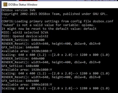

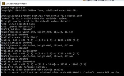

Reply 279 of 733, by KainXVIII
Ant_222 wrote:
Since I still can't reproduce the error will you please tell me whether you enter the pass code and start the game before switch […]
Even on very first Megatech title screen games crash if i switch to windowed mode.
UPD - with windowresolution=desktop its not!
Here is log with windowresolution=original
184.31 KiB

And here is with windowresolution=desktop (maybe it helps)
123.75 KiB
