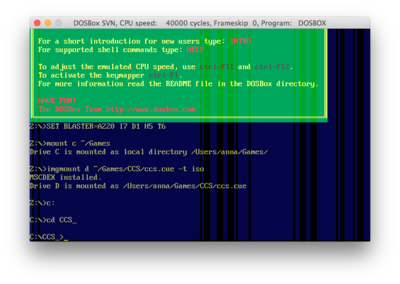

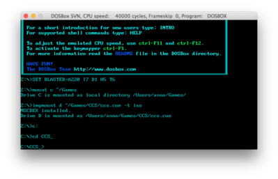

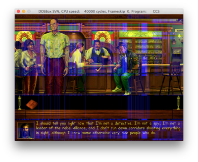

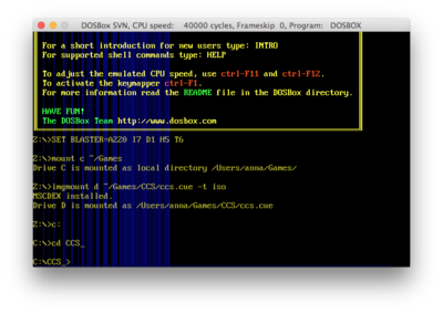

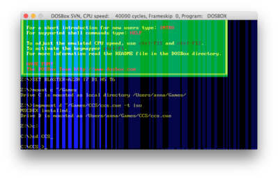

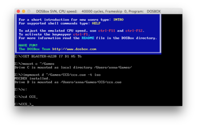

Reply 380 of 733, by Solanacean
Ant_222 wrote:
Solanacean, please replace the function ssPsEndUpdate in sdlmain.cpp with the one attached and test again.
Unfortunately, the glitch is still there.
Reply 381 of 733, by Ant_222
If so, can you please delete the conditional compilation and test with
pix_out.pixels += 1;
EDIT: The bug is caused by this offset in the reading of pixel values:
A B G R
b g r
i.e. alpha channel (random value) is read as blue, blue as green, and green as red. This is why the screenshots have no blue color except in (semi)random blue stripes and why white is shown as yellow (g+r). Once you help me to confirm that this is the actual problem, I will find a way to treat pixels in a format-independent way.
Reply 382 of 733, by Solanacean
Ant_222 wrote:
If so, can you please delete the conditional compilation and test with […]
Now it crashes with a segmentation fault.
Reply 384 of 733, by Solanacean
Ant_222 wrote:
Can you try it with […]
Can you try it with
machine=ega
The build with the conditional compilation directives commented out: no blue strips.
Reply 385 of 733, by Ant_222
Thank you very much. It is very late now, so I must to bed. Tomorrow I shall give a code to output the properties of sdl.surface->format: Rshift and Bshift. There must be some difference in the RGB(A) layout between our machines. If you can look at them yourself, then please do. This is a global variable available from ssPsEndUpdate() and initialized by the time it executes.
Reply 386 of 733, by Ant_222
I have reproduced this by exactly the opposite modification (decrement by one). Please, try again with the attached function.
    ssPsEndUpdate.cpp
    874 Bytes
    59 downloads
Reply 387 of 733, by Solanacean
Ant_222 wrote:
Reply 389 of 733, by Ant_222
Can you please replace 3 with 4 in the rgb_32_fmt structures as shown in formats.cpp and restore the function ssPsEndUpdate.cpp to its original state (attached), and try again. No need to test several devices, just test with ega.
EDIT:This should help with surfacepp and surfacenb, which copy pixels as memory blocks, but not with surfacenp/i], which extracts individual channel values for interpolation.
    ssPsEndUpdate.cpp
    561 Bytes
    69 downloads
    formats.cpp
    187 Bytes
    54 downloads
Reply 390 of 733, by Solanacean
You're awesome! 😀 Everything looks fine now!
