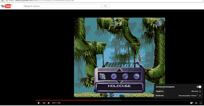

KainXVIII wrote:
Ant_222 wrote:
Thank you, but I couldn't make that video play pixel-perfectly. Can you?
What do you mean?
That at 100% zoom set in the browser your video has dimensions other than a multiple of the original and is blurry.
Reply 78 of 733, by KainXVIII
Ant_222 wrote:
KainXVIII wrote:
What do you mean?
Hmm, are you sure that video quality is set to 1080p/60fps? And of course youtube encoder will add some blur (but not that much)
