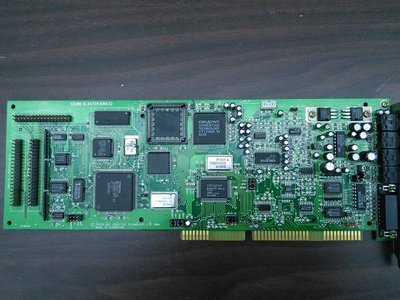

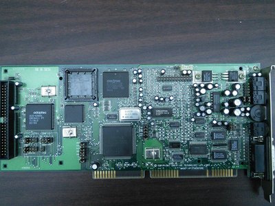

Reply 24 of 80, by rick12373

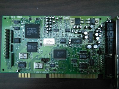

I have been digging through my storage and I have 3 prospective sounds cards and an I/O card made by Promise (still boxed!). The sound cards are:
Sound Blaster 16 Value (CT2770)
Sound Blaster SCSI (CT1770)
Sound Blaster Awe32 (CT3780)
I think the Sound Blaster 16 is a better fit for a 486 of the era. Would there be anything wrong in using the SB16 Value? I could use the SCSI SB16 and use the I/O card for the connection of the CD-ROM.

Reply 25 of 80, by brostenen
rick12373 wrote:
I have been digging through my storage and I have 3 prospective sounds cards and an I/O card made by Promise (still boxed!). Th […]
I don't know anything about the 1770 and the 3780. I have only owned a 2770 once, and it is really noisy.
I bought it new in 1995, and it had that "static" noise going all the time and I could hear the HDD reading and writing,
through the speakers. I actually did not need a HDD-Led 🤣 On the other hand, it is quite compatible with SB16 games.
If the 1770 has lesser noise, then choose that over the 2770. If the 3780 has no OPL chip, then avoid it.

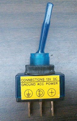

Reply 27 of 80, by TheMobRules
rick12373 wrote:
I also have a converter for the PSU but I think it is designed to let you use a modern PSU with an AT case and motherboard. I want to use it to let me use the old motherboard with a modern PSU and ATX case. There are 2 wires coming from it that I assume would be used to connect to the old power button on an AT case. Could they be adapted to connect to an ATX case power button? Or do I need to get something else?
You cannot use the adapter directly with the ATX power button since you need an on/off type switch, ATX power button is momentary. To use an ATX case you have 3 options basically:
  • Connect an old AT power switch to the adapter and see if you can fit it in your case instead of the ATX power button (uncommon, but some older ATX cases have mount points for AT style switches)
  • Replace the momentary ATX power button in your case with a self-locking button of the same size (generally it's one of those little square buttons, they are available for very cheap on eBay) and connect the new button to the adapter
  • Leave the ATX power button as it is and try to mount an on/off switch somewhere else in the case (i.e. by drilling holes, or on a PCI slot cover)
Reply 28 of 80, by rick12373
I think I might have some on/off switches somewhere. I will see if I can mount one somewhere on the case. So far this ATX case seems to match up well with the AT board.

Reply 29 of 80, by gdjacobs
TheMobRules wrote:
You cannot use the adapter directly with the ATX power button since you need an on/off type switch, ATX power button is momentar […]
You can also create a latching device which triggers on or off from the momentary switch. This can be done using flip flops, transistors, a micro controller, etc.
Changing the switch is easier, though.
Reply 30 of 80, by rick12373
OK, forgive how useful I am being, but I found a switch in my random stuff. I have attached a picture. How would I attach this to the power adapter previously pictured? The wires that are supposed to go to the power switch from the adapter are black and green.

Reply 32 of 80, by brostenen
Green wire goes to the "plus" on the switch, the middle is for the light inside the switch, and the third is ground that goes to a black wire.
Reply 33 of 80, by rick12373
brostenen wrote:
You sir are awesome! I really should have known that! 😕

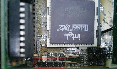

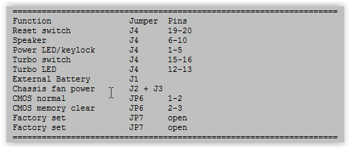

Reply 38 of 80, by rick12373
OK, I have looked at pin diagrams 100 of times before and connected them up on more modern boards. But this one has me a bit confused. I have the pin out information from http://motherboards.mbarron.net/index.html but I can't seem to get my head around it. When I actually look at the board I can't seem to identify which pin is which. I think I see "20" written at the bottom left but then that would make the pins go from left to right, unless I am looking at it upside down. Anyway, I will post a picture of the motherboard and the info from the web site. Maybe one of you learned gentlemen can set me straight.

Reply 39 of 80, by TheMobRules
Based on the white mark in the top right of your picture (which should be pin 1), the "20" on the lower left and trying to match the diagram with the text on the board, this would be the pinout for the front panel on the picture you posted:
10 09 08 07 06 05 04 03 02 01
20 19 18 17 16 15 14 13 12 11
BTW, this will also be very useful for me since I just got a VI15G and will get to pick it up in a few days! 😁
