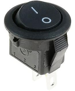

Reply 23 of 57, by FFXIhealer
Whiskey wrote:
200W AT Power Supply (The GA-5AA supports AT & ATX power. However the current AT power supply is wired directly into the power button and heat shrink'd. Any advice on changing over to an ATX 450W is welcome.)
25.82 KiB
1509 views
To get an ATX power supply to work, one of two things must first happen. One, the motherboard has a power switch header (two pins) that when shorted will turn on and off the power from the MB. This is a typical PC power switch and connector:
Wire up a switch to these two pins so that it shorts the connector when you press the button and it should do an ATX power supply just fine. If not, let us know and I have an idea (number two) to nearly hard-wire a SPST switch to the 24-pin ATX power supply motherboard connector directly to do the same job.
This is a Single Pole-Single Throw (SPST) switch:
