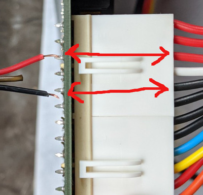

Here is a pic of the 3 pin connector from the PSU and the relevant section of the mobo:
The 3 pin connector goes just to the left of the 2 pin yellow and black power switch wires.(please excuse my god awful soldering skills 😁)

Reply 1 of 16, by Brickpad
You might be able to cut the three-wire connector and connect two of those wires to the ATX ground and power_on (black and green wires respectively). Not sure what the third wire does, but I am wondering if it's the power sensor.

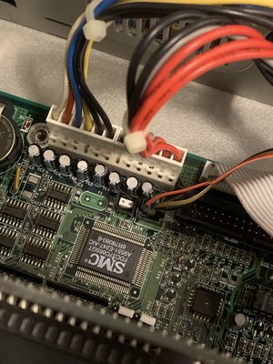

Did you ever figure this out? I have a motherboard from a 330 that I’m trying to power with a regular AT PSU 😕
Reply 4 of 16, by airs
Figured it out!
Some IBM motherboards require an additional three pin connector that needs +5v (left, red) and ground (right, black). The middle pin does not need to be connected to anything. You can then use a regular AT PSU by shorting the two pin connector (white jumper), and then supply 5v and ground from a molex connector. This way your AT switch will still work to turn the PC on and off.

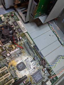

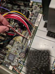

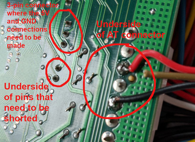

Reply 5 of 16, by thp
Thanks for this, I've tried this on an IBM Aptiva 486 board with an ATX power supply and an ATX-to-AT adapter and successfully got it working again.
I decided to take the 5V and GND from the AT connector but without modifying the AT connector (or a molex connector) so that the board basically acts like a self-contained AT board -- see the photos. After doing it, I realized I could just do the connections fully on the underside of the motherboard, but so it's at least a reminder that those connections are there (and I did have the jumper wires with the plugs from some other project).
Has anyone figured out if there is a function to the middle pin and/or the two shortened pins? Would it be possible to connect a switch there for e.g. the fast resume, or is this all handled elsewhere anyway?

    Planned 5V and GND points from AT connector

    Solder points and potential bottom solder points

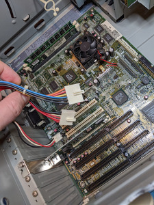

Hi! I've been following this with great interest, so thanks for revisiting these! I recently came into an old IBM Aptiva myself. It's using a similar board with what looks like a 3-pin molex connector, but same wiring.
I'd like to replace the ancient PSU with a new ATX one. But I'm a little perplexed as to how I should handle the switch. I'm using an ATX to AT converter, but I'm unsure with what to do with the green and black AT power cables. I have no AT switch, and the Aptiva's power button does nothing. I've confirmed that I can get the system to start by shorting the AT power switch cables, but the unit powers down the moment I break the connection. Any suggestions on how I should approach this?

Reply 7 of 16, by quicknick
I'm 99% sure that on the 3-wire molex black is GND, white is PS_ON# (green on ATX) and red is +5Vsb (purple on ATX).
For the 1% uncertainty you should use a multimeter: see if +5 volts are present on the red wire with the system connected to mains, check if PSU powers on when shorting white to black (all this pertains to the 3-wire molex).
When you're at 100% you just need to connect three ATX wires to the molex. You already have two of them hanging from the ATX-AT adapter, the effort will be to find a way to connect the purple one.

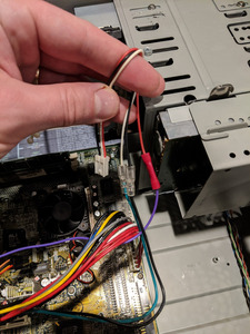

Reply 9 of 16, by Kozality
That did it! I wired it up (It's quite messy) but after having reversed my 5v and ground lines, it powered up fine. I'm hoping to make it a bit neater in the future by getting the right crimper and connectors (the one I got didn't work) but for now it'll let me test.
Here's my pictures for future reference.

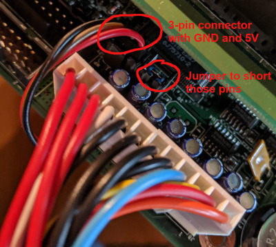

I'm so glad I found this thread! My old Aptiva (2144-888) from 1995 stopped working maybe 7-8 years ago and I do suspect it's the power supply. I stupidly had it connected to the mains all the time, which I guess eventually wares out the PSU. The caps on the motherboard at least visually all look fine.
I do have an old(er) 300W ATX power supply from 2002 with a 20-pin connector and a powerful enough +5V rail. It also does have the -5V rail (white wire), which not all modern ATX power supplies have appparently, since it's deprecated. This PSU is completely unused, since I just pulled it from a case I bought around that time. It also has a rear mounted (80mm?) fan and the same physical dimensions as the one in the Aptiva, so it's a great candidate for this project!
Kozality wrote on 2020-03-18, 00:36:
quicknick wrote on 2020-03-17, 23:45:
Thanks! I'll give that a shot. I've ordered some molex crimpers; I'm going to see about attaching some new ends and then modify the wiring harness. I think I can probably get the purple in since it has no corresponding pin on the ATX to AT adapter, so I'll run a new wire off of it to the three pin molex. Updates to come.
This makes so much sense now. When I first opened up the case I couldn't figure out what weird proprietary solution IBM just HAD to use here, but when you consider what it does with the soft power switch and how that later became standard in ATX, this is more of a modernization of AT, a stepping stone to what's to come, so they're forgiven. 😀
I'd like to avoid getting any special tools and just find a more plug and play solution to this. I'm thinking of getting a standard AT to ATX adapter (with the two power button wires hanging off of it) and then getting one of these (male to female) and just use three individual wires to connect:
Red mobo - Purple PSU
Gray mobo - Green PSU
Black mobo - Black PSU
Do you think that will work?

Reply 14 of 16, by AtomicPlayboy
I've completed this upgrade on my IBM PS/1 2168, following the same approach as InterClaw (thanks for that), and now I have a nearly silent PC instead of the previous leaf blower. The odd thing - when I hit the power switch on the PS/1 (not the switch on the PSU, which I am using to power on/off the machine), the display turns off but the machine stays on. Hit again, and the display comes back on. The BIOS does reference some power management capabilities, so I guess this is a power state being intentionally triggered. But with the original PSU, this activity would have simply turned the whole PC off.
Curious if anyone else has this behavior, and can explain why it's occurring.
