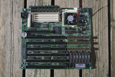

Hi all,
I recently picked up a really beat-up DX4-100 system from a flea market. The motherboard is a QDI manufactured part marked V4895P3/SMT V5.0 and it looks really nice (VESA, button cell battery, etc.) but unfortunately it is completely dead. The PSU seems OK, I've gone through all the usual troubleshooting steps: tried booting with a different CPU, different RAM etc, CMOS reset, etc etc etc... but there's no sign of life whatsoever. The drives don't spin up, it doesn't beep, nothing. Dead.

The old, broken board with cache chips visible

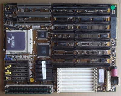

So I've written it off and ordered another, working motherboard, which is on its way to me as we speak. This new board is an M Technologies R407 E/V which after looking through old Usenet posts was apparently a really controversial board back in the day. Apparently some or all of the boards marked "E/V" have fake cache or a mixture of fake and real cache (they would have 0 or 128K of real cache but have a BIOS hardcoded to report 256K). But unlike PC Chips boards, the fake cache is at least socketed and the board should accept real cache if you install it.
From the photos of the board I ordered I can see that only half of the slots are populated, but I don't know yet if I'm going to receive a board with 128K of real cache or 128K of li'l plastic boxes with legs.

This is the new board I ordered, with suspicious-looking cache

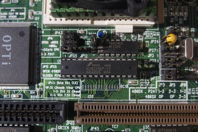

Question #1: the defective board has 256K of (AFAIK) real 15 ns cache. I assume I can just take these chips and plop them into the new motherboard? Here's what I don't get though: the CACHE TAG RAM. The new board has a slot for tag RAM right by the eight cache slots. On the broken board though, am I correct in assuming this is the tag RAM chip pictured below? It's marked NKK JAPAN N341256P-15 which is a 15ns 256kbit static RAM so I'm pretty sure that's it, but I feel like I gotta double check.
Yes, that's the TAG RAM. Dunno if it's the correct size for your new board, though.

Does the correct size/type of the tag RAM chip depend on anything other than the size of the installed cache? I'm thinking I'll replace all the cache chips from the new (MTI) board with the ones from the dead board.
What about 32-pin vs 28-pin cache chips? Are they interchangeable? Looks like the dead board has 8 x 28-pin chips and the new one has 4 x 32-pin...

Anyway, the new board arrived and the system works totally fine with it! The board came with a 486 DX/33 and 8 Mb of RAM installed so that's what I'm using at the moment since it's a known good configuration. Will update later to the DX4 that came with the first board.
The VGA card works, the multi I/O controller works, the hard disk works. It boots into DOS 6.22 and Windows 3.11 for Workgroups. Seems to have been someone's home computer, lots of Word and Works documents and even old scanned pictures of normal family stuff. System was last used in 1999. It's always kind of a weird feeling to dig through someone's old stuff.
Anyway, the cache issue. The system reports 256K L2 cache on boot, but that's what I expected since apparently all MTI boards do so, whether the cache is real or not. I transferred CACHECHK to the system and ran it. Got this output:

So... That's good, right? Isn't CACHECHK pretty much impossible to fool? Do any of the numbers look weird to you guys, or is this a real bona-fide 256K cache system? Sure looks like it! 😎
