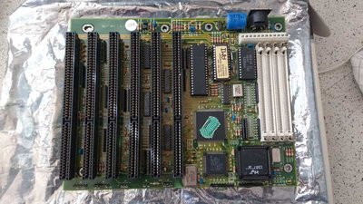

This is my 386 board. Not fast, nor slow for that matter. It is faster than my 286 8/10mhz machine,
and I have a 486dx33 and a 5x86-133 if I want to run faster than the 386.
So my answer to you'r 386 build, is to start building with some mid-range stuff, then get some 486
if you want a faster machine. Like a 486dx2-66/80mhz.
