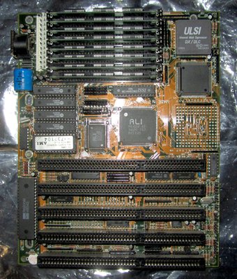

Meanwhile I've decided to skip PC Chips offer and instead found this cute board - SER 386-AD3
871.88 KiB
1558 views
AMD 386DX 40, ALI M1429 (486 chipset?), 8mb 60ns RAM and 15ns cache. To my surprise even battery is still fine. Possible 256kb cache upgrade?
