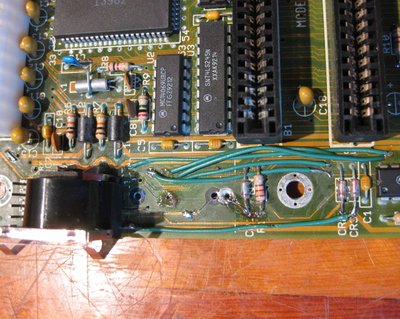

Reply 212 of 287, by feipoa
You don't use acetic acid (vinegar) at all? About what volume (e.g. teaspoons, tablespoons, etc) of dish soap and baking soda (e.g. grams or tablespoons) do you use per volume of water? Before and/or after scrubbing, how long do you let this solution sit on the board? Do you only use water to rinse, or do you use any contact cleaner as the final rinsing stage? Do you de-solder any components which have corrosion around them, e.g. the DIN-5 keyboard connector, DIP sockets, DIP IC's?
Can the blue corrosion make its way into the transistors of the IC's and affect gate conductivity? I have experienced issues with an RTC crystal oscillator circuit loosing precise timing with continued growth of corrosion. Many years ago, I cleaned up a board which experienced battery acid leakage. The clock timing as off. I replaced the crystal and small capacitors around it. This seemed to fix the clock timing issues. Then years later, the clock timing issues returned. I am not positive if it is due to corrosion, but over those years, some signs of blue corrosion had returned. So I was wondering if some of that corrosion can hide in IC's and components which do not get properly cleaned.
I found the best way to solder 30 AWG wires to traces is to use a flux pen, though it is still time consuming. I usually trace the broken trace from end to end and solder the new wires on component through-holes.
Back in the early 90's, super glue worked like magic. That stuff would bond within 15 seconds. I have not been able to find the same kind of super glue these days. Today's "super glue" and "krazy glue" seems to take minutes to bond and doesn't hold as well as the stuff from decades past. Was the original "super glue" banned in certain regions of the world?
I have an assortment of solid-core wires gauges from 20 to 30 AWG, in 2 gauge steps. I usually use these wires to "floss" vias which have been corroded. It seems like tapered tips, like dental instruments, don't scrape the centre of the via all that well, although I usually start with tapered tips to clean the outermost part of the via.
I have a SiS Rabbit board, a Chaintech 340SCD, which I repaired many years ago which I would like to redo the wiring on so that it doesn't look so messy. I'd like to use 30 AWG wire on this re-repair. It seems like the acrylic conformal coating may hold down the wires if applied thick enough.

Reply 213 of 287, by matze79
The battery stuff can get into the pcb, beetween layers.
You really need to desolder everything and neutralize this stuff by putting the whole pcb inside vinegar for some time.
i also have a handful of boards i fixed, some of it have now broken via's.. i used a ultra fine drill and fine wire to fix them.
i did not clean everything 100% which now takes revenge, years after.
Also had the same clock problem with a 486DX50 Mainboard, the clock seemend to work faster then slower..
replaced capacitor and clock crystal, and it worked again, but not perfect.
i had to replace the RTC Chip too.
The stuff also gets inside the glass of the diodes and eat them up.
Ón a Compaq LTE Laptop Capacitors leaked and destroyed traces inside the PCB.. very annonying repair..
Capacitors make much more Damage.. i now have a Sanyo 386 Laptop here also with leaking capacitors..
