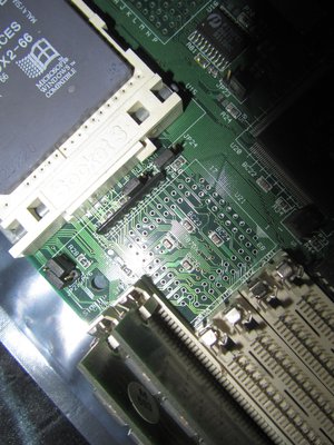

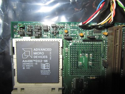

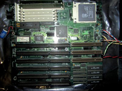

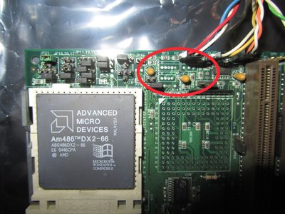

Soo... acquired the best (tm) motherboard for 386DX I could find. VLB, 256kb Cache, Cyrix 486 support, etc. Well, almost: sockets for 386 CPU/FPU are not soldered, but apparently my version of Dataexpert EXP4349 board is lacking only in that department. All jumpers from online manuals appears to be present. So all I need to do is to add those sockets, right? Or I'm missing something?
1.08 MiB
1153 views
688.99 KiB
1153 views
844.62 KiB
1153 views
Also I'm confused with 3.3v option for CPU without voltage regulator present on the board (jumpers 50, 51, 52).
Reply 283 of 287, by feipoa
It probably doesn't have a 3.3 V option without the voltage regulator, so set the jumpers for 5 V.
In all liklihood, soldering in the 386 and FPU sockets will allow you to use 386 CPUs. Aside from the missing voltage regulator, are there many missing components?
Reply 284 of 287, by The Serpent Rider
I am not sure where voltage regulator could be installed on this board.
323.49 KiB
1136 views
Maybe here vertically?
That's what I want to know from the other owners. Jumpers are safe, components seems to be safe too, judging by this pics: https://imgur.com/a/sZPMB
Reply 285 of 287, by feipoa
Yes, that is the spot which I would guess the voltage regulator IC goes. What I find further interesting about those photos on imgur is the sticker "This PGA socket is intended for TI486SXL Microprocessor only". I've never seen such a sticker on a motherboard. I'm guessing that certain jumpers were soldered on for the SXL pinout, which has some minor differences with the i486SX pinout, yet, an SX CPU is installed.
