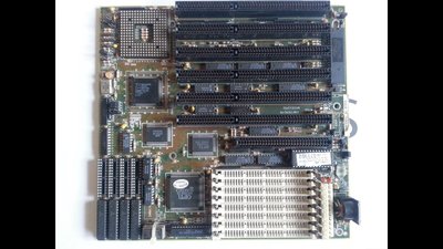

Well you got lucky i guess, otherwise there is no chance if the seller knows what he have... That type of deals are the very best when the seller does not have a clue what he holds, this is how i did get IBM Model M gen 3 for 5 euro, or now P3B-F for like 6-7 euro, but that happen once in a years if lucky...There are also people that know very well how much their old hardware costs and if its priceless, but they just don`t need it anymore, they don`t have space to store them, and they just give them away as presents, this is the best that can happen to a collector, but it happen very rarely, rest of the time i need to hunt parts down, to look for them in sites like ebay (but not ebay) to look just for old computers as many people don`t have a single clue what is inside the white old case, this is how i did found ASUS P2B with working Quantum 10GB and AWE 64 Value, i found some computer that did have pictures only on the outside, so i did ask for pictures inside and i saw the AWE 64 and P2B, but it takes time to do so, but when i found something is very nice for minimal cost...
Im not sure if some chipsets are better on 386 boards or not, some boards specially the ones with OPTI chipsets seems very retarded as they don`t if i don`t fill all the RAM slots, also they don`t post if they don`t like the ISA video card even if its Trident...
Now im having problems running OPTI board but it is with a damn AMD DX CPU and i want to make it alive, but so far nothing, the batter was leaked and there is little damage, but i think it should be fine, the CPU is getting hot after a while so that is good thing, but no matter what i try the damn board just don`t post, for now i don`t have 8 SIMM modules to fill all the slots and to see if it will run...
