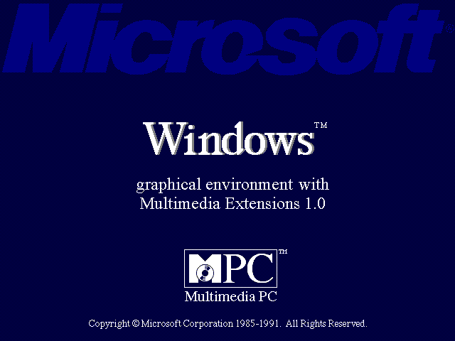

computergeek92 wrote:
What else do you know about Windows 3.0 MME? Is it simply "Microsoft Plus" in terms?
Hi, yes, you could say so. However, Windows 3.0 with Multimedia Extensions was also truely a special edition.
It was made available to OEMs like Tandy to support all kinds of (then new) multimedia applications.
Like computer-controlled LaserDisc players, encyclopaedias with built-in videos/sounds or educational software (apparently this was a big thing back then).
Because of its multimedia nature, it was also the first Windows to be released on a CD-ROM:
Windows 3.0 MME (aka Windows /M) was released about a year before Windows 3.1 and contained several new programs,
like Media Player, several new screen savers and a new help system from Win 3.1 alpha/beta versions.
It also came with new and interesting colour graphics drivers which never made it into 3.1..
Oh, and the "386 enhanced" icon now included the ability to manage swap files (no FastDisk, though).
Some Windows 3.0 games also made use of the new audio capabilities, which were later included in Windows 3.1.
One of these games was "Stellar Explorer", a freeware game.
If you want to learn more about it, have a look at the GUI Gallery.
There are also a few threads/videos about it on the web (1,2,3,4,5)
Here's something a bit more general about Win 3.0..
Nostalgia at Windows 3.0 turning 20 (2010)
Windows 3.0 (virtuallyfun)
Windows 3.0 DR 1.14, from February 1989 (OS/2 Museum)
Retro development with aclock
Windows 3.0, The Computer Chronicles
Windows 3.0 (Byte Magazine)
    8.4 KiB
    679 views
