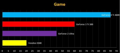

How to improve graphs : Think about limiting information on graphs.
Something like this (example) :
40.87 KiB
494 views
You know what is where (name wise), and seeing what exact performance X card get isn't too difficult.
There should be option to make result values show on both top and down of the grapgh... don't quite know how to do it yet tho 😉
Adding table with results to graph can help as well, but I don't think it's nessessary.

The thing with the graphs is that they are part of a video with me talking about them. I reveal line, by line... Well, you'll see what I mean 🤣
YouTube, Facebook, Website
Reply 44 of 55, by agent_x007
Revealing is fun 😀
Searching for cards name in the bottom isn't.
I think that cards name is more important than actual score (in this case), and that's why I used cards name on the result bar.

Next time try to keep the colors consistent between the graphs if you're posting a bunch of them in a row, provided that it makes sense?

Yup, noted, Elinda also mentioned this 😀 This is an easy fix, rather than deleting the cards that can't do 32 bit, just zero them.

agent_x007 wrote:
Revealing is fun 😀
I also struggled a bit with this. Especially in the more crowded graphs where there were a lot of very similar colors.
You won't lose the suspense of the reveal by adding the name of the card directly to each bar.
