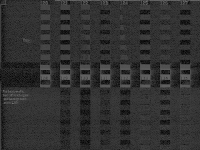

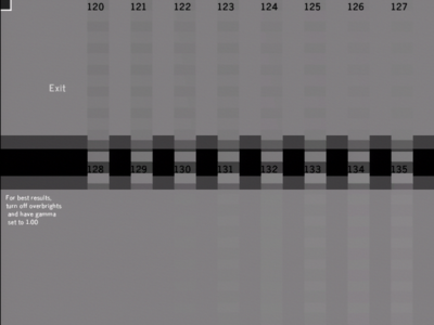

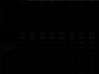

Reply 3 of 6, by leileilol
Thanks, diffing on that allowed me to see the dac at work. You can see the filter eat away the dither pattern completely
Interesting parts:
- the left edge doesn't bleed as much on the red and blue channels
- the faint purple lines seem invisible
- green is very much biased
    88.57 KiB
    318 views
    249.79 KiB
    324 views
    279.62 KiB
    324 views

Are you sure that's the result of the 3dfx DAC and does not come from the capture card's ADC?

Certain. On high gamma situations on a real CRT you can notice some blurry streaks towards the right if you look hard enough, and it also tells me i need to have more precision to use in my shader and have less hard caps and something exponential
