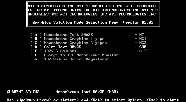

...aaand the ATI disk I had memories of, just as I was starting to believe I'm getting too old and loosing it, revealed itself. It was lying under our eyes all this time.
This is the full/ATI branded Graphics Solution disk from 1987, as found at minuszerodegrees.net (a site of amazing content I must say).
http://www.minuszerodegrees.net/manuals/ATI%2 … sion%201.00.zip
4.69 KiB
508 views
It's the disk which came with my first PC clone mentioned earlier having an ATI logo on the label. It's not showing on the dosbox screenshot I just took, but it actually has a menu bar 😀 It's a slightly later version of what Scali kindly shared.

wow that's cool. That means dip-switches stay hercules, monitor stays hercules,
but software emulates and displays CGA...that's cool! no ghosting, no scanlines,
wow that's REALLY cool. ...but useless for my euro pc with HGC/CGA Paradise-Chip 🙁

I believe the Paradise can do the same thing.
