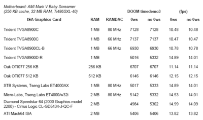

These are some comparative results I recorded when I benched my ISA graphics cards on a high-end VLSI-based 386 motherboard w/DOOM.

That confuses me a bit. Is the reason for better result's, the motherboard, cpu or both?

I think it's more to do with the motherboard, but the CPU could also play a role, since the Ti486SXL-40 has 8 KB of L1 cache, as opposed to 1 KB of L1 cache on the Cyrix 486DLC-40 (would be interesting to see how these two CPU's stack up against each other in benchmark tests like NSSI 0.60, Norton Sysinfo 8.0, Landmark 2.0, etc.)
I recently benchmarked my Cyrix 486DLC-40 on another hybrid 3/486 motherboard that has an OPTI 495XLC chipset (using similar BIOS settings).
On that motherboard, I only managed to get 7924 realticks (equates to 9.43 fps) with my ET4000AX, which is quite a significant diferrence and proves that, in this case, the motherboard/chipset can play a large role.

From what I can find here on this forum that SXL is a good deal faster than the DLC by far.

Hmmm. So the extra cache is what makes the ET run faster? No cache = no need for anything else than trident's then.
