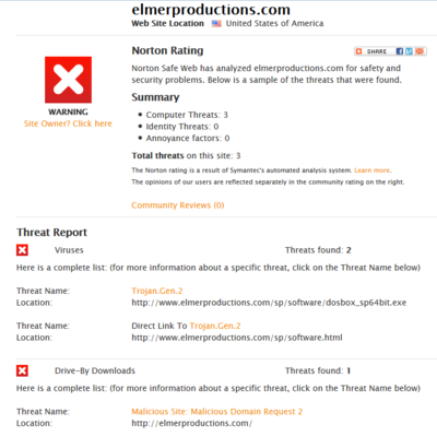

Reply 32 of 53, by clueless1
In that case, I'll see if I can duplicate your bug this evening. My filtering DNS says that site is malicious. 🤣. But I somehow think that is a false positive.
