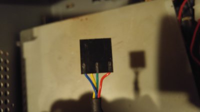

Of course, I have run into more issues. CTMouse doesn't detect the mouse (I have a ps2 bracket adapter connected to the mouse port on the motherboard.) Also, when I connect a cdrom to the secondary IDE port, it cancels out the Primary port. Argh...
Reply 12 of 34, by Imperious
It might help if You could post some decent photos of Your board, etc. What brand dx2-66 are You using?
I have no idea what your skillset is but a common error is to connect the floppy drive cable backwards on the drive, it should be opposite to cdrom/hdd.
If the mouse adaptor is a simple Serial to ps/2 adaptor it likely won't work, get a proper serial mouse if you can.

I build computers of various sorts. I have three retro hobby computers I have been working on. The last 486 was perfect until the board died; it had PCI slots and PS2 ports for keyboard and mouse. Some of this is new, such as the CF-IDE adapter, etc.
I uploaded a pic of the mouse connector. I was limited to what I could upload. Maybe it is wired differently than the five pin layout on the 4dps. I solved the 2nd IDE port issue and have a slot load drive running on it, and i solved the floppy issue. They were related to the faulty CPU, which now has a replacement Intel 486DX2 - 66 installed. The only remaining issue seems to be the mouse connector not being seen by the driver, though it does power the optical mouse when connected.

Thank you much, for your reply. I will look into the bios chip issue. Do you have any information on the mouse issue? I am still thinking that my connector's wire layout differs from the mouse pin layout. I have the one 5 pin, single row connector, and a 2-row connector which will not fit, but has a different wire scheme, so I think that it isnt standard, and net searches are not providing much inn the way of PS2 connectivity on this particular board. I have a ps2/serial adapter here somewhere, and a usb-to-serial adapter, but I am reading that the power carried by the serial ports may not support an optical mouse, so I am searching for an answer to that issue, whether a proper motherboard connector, or some kind of dos-friendly PCI PS2 card.

I am going to mess with pins and wires soon. First, I am going to test with another mouse or two. This optical mouse lights up when I use the PS2 port, though without being detected by CTMOUSE. I just connected it to the COM1 serial port with an adapter. The mouse remains unlit until CTMOUSE loads, and then it lights up, but still has no movement. Mouse was tested to be working on an Athlon XP system.
Reply 19 of 34, by Scythifuge
No mice work with 2 different ps/2 to serial adapters. A serial track ball works. On my ps2 connector, I swapped the yellow and blue wires, and CTMOUSE still doesn't see a ps2 mouse.
