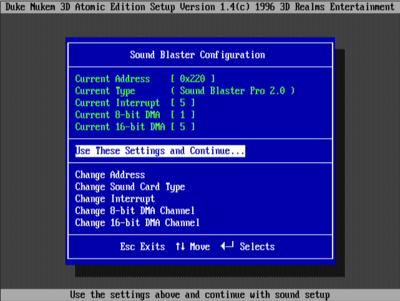

When Sound Blaster Pro switches to stereo mode it halves the sampling rate from 44k.1Hz to 22.05kHz, only certain games use the stereo feature of the SB-Pro.
Some of these games will leave the SB-Pro in stereo mode after you quit the game but the problem is the sampling rate is still halved so other games will not sound right.
To quickly recreate this bug:
1. Enter Duke Nukem 3D setup, Choose SB-Pro 2.0 from Card Type.
25.91 KiB
734 views

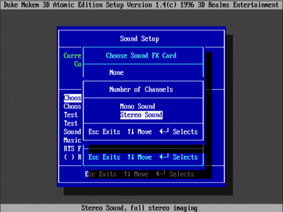

2. Continue the setup and make sure you select Stereo:
25.91 KiB
734 views

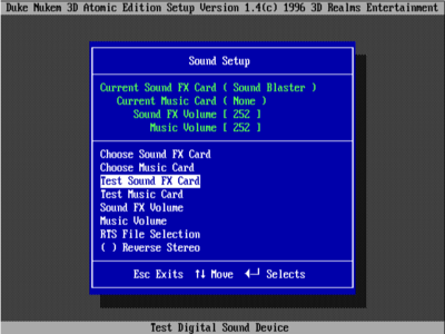

3. Now the important part that actually creates this bug.
Play the Test Sound.
24.04 KiB
734 views
Exit the setup, save or not save, doesn't matter, the damage is already done, the sampling rate is halved.
All you have to do is play a game like Prince of Persia 1/2, Mortal Kombat 2, Supaplex, or any other game that don't have its own SB driver (not Doom),
you'll hear terrible low sampling rate sound effects, half of what it should be.
To fix this simply do the same but choose Mono in the setup and play Test Sound, now the SB-Pro should be back to normal.
