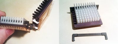

My socket 3 has the fat, off-center tabs. What is the best way to attach a larger, modern heatsink to a socket 3 CPU? I know I don't need to; it is for a special project. This is for a Tomato 4DPS board.

You can use a large paperclip or a piece of steel wire to make someting like this:
- and use any socket 7 / small socket 370 heatsink / fan. Even some mainboard / video card heatsinks will fit.
The trick is to bend the wire / clip so that the ends come under the off center tabs, but to also bend it in the middle, where it goes on top of the heatsink so it can put pressure on the heatsink.

Not sure how heavy heatsinks could be used with that, but I designed and 3d printed clips for mounting the heatsink directly to the CPU (black ones). These must be printed with ABS, not PLA.
But earlier I made a prototype (white clips), just by cutting it from HIPS polystyrene sheet. Maybe you would be able to cut such clip from an old piece of plastic, like DVD case. Such clips were a standard for mounting lightweight radiators to old CPUs.
I also tried bending a paperclip, but it needs to be done in a precise way 😁

I have the z-clip pictured above, though I wasn't sure how it connected to the fat tabs on my socket.
I would try the plastic clip idea, but I need to put a 60mm with an 80mm adapter on it.
