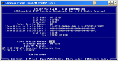

Thanks for posting these versions! 6.24T uses the HiFlex default instead of the Color default, and can edit the Hardware Monitor tab on BIOSes retaining support for WinBIOS and Hiflex client editing. It also doesn't have the I/O header error which a previous version of 6.24 non T had on here, meaning you can load a BIOS from within the program. 6.21 is very close to 6.24 and there isn't much difference between the two, aside from one being older and maybe slower. 6.24E is a dud and does not work, attempting to load a bios but then blocking you off from loading it with an Evaluation message even when the date is set back. Perhaps someone could remove the Evaluation block on 6.24E and W5.11E (posted here a while ago, broken and also evaluation) to get something useful out of them, especially as W5.11E is the only availible version of AMIBCP 5 on the Internet AFAIK.

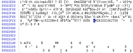

Thanks for the reviews guys, I'm glad at least one of the BCPs provided worked as intended.
As for the "Header not found!" error, I've checked a bit, and it turns out AMIBIOS Core 5 and downwards have a different "SLAB" (INIT) module header structure. BCP6xx expects to find an "AMIBIOSC" string, in uncompressed form, near the end of the BOOTBLOCK region, and below the ESCD defaults area, as shown in the pic (from a Pentium board ROM called 5vim001.bin, which works just fine with BCP621 and BCP624T).
7.71 KiB
2107 views
14.14 KiB
2103 views

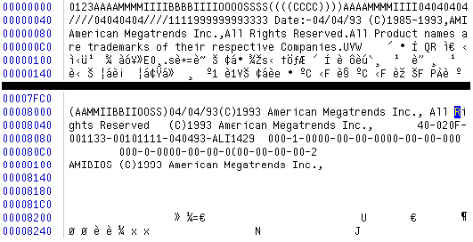

This seems to be an standard since BIOS core v6xx and upwards, But I've checked older BIOS cores (namely '94 and '93 core dates)... And the structure is everything but standard.

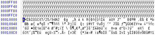

For example, PCEm hot-433.ami (dated '94, looks like core v5xx) has the string in middle of the rom, at what looks like the end of the "SLAB" module. BCP6xx doesn't seem to like that...
4.64 KiB
2107 views
Our next example, PCEm ami486.bin (dated '93, probably core v3xx or v4xx), doesn't have the "AMIBIOSC" string at all, and the modules seem all in uncompressed form. Is clear this will not work with BCP6xx.
7.74 KiB
2107 views
And finally, Nexgen AMI BIOSes are compressed, but them don't have the "AMIBIOSC" string at all, so them will not work with BCP6xx, as it doesn't know how to uncompress the modules without that.
In resume... Looks like versions of the BCP program specific to the core them are shipped, are truly needed to manage the ROMs produced by these codebases. Unfortunately, by checking the evidence, we can conclude these programs aren't retrocompatible at all (in a sense, that would explain why core v6xx roms get potentially corrupted when edited by the popular DOSExtended BCP7xx program, even if at first it looks like them were opened succesfully).

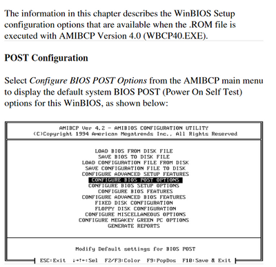

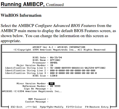

Here's some recreations of AMIBCP 4.2 (wbcp40.exe) in action, found inside of a wordperfect format AMI WinBIOS chipset manual. These come from an archive of the AMI FTP, which can be found here (https://ia601602.us.archive.org/view_archive. … atrends.com.tar, winbios chipset manuals are inside of the "other_manuals" folder, the files are .zip files with renamed extensions with the wordperfect doc inside)
There are other manuals for other AMIBIOS cores too, so perhaps there are more screenshots inside those that i haven't found.
Edit: This also confirms that wbcp40.exe can open 06/25/94 cores.

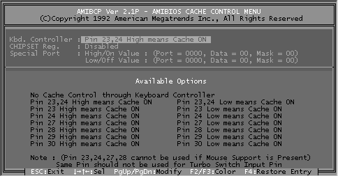

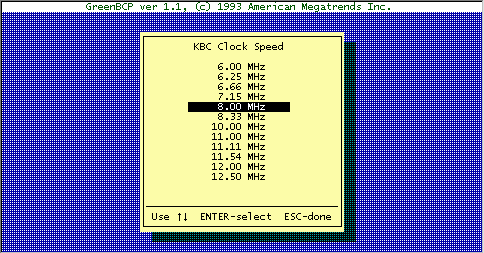

Reply 89 of 95, by Horun
Uploaded Borg Number One BIOS Tool Collection to archive org software. Search bnobtcv5
also posted AMIBCP v2.25beta for Windows in this topic: Re: AMIBIOS Modding (Looking for AMIBCP for Windows 2.x)
figured I should include the info here for those following this topic...

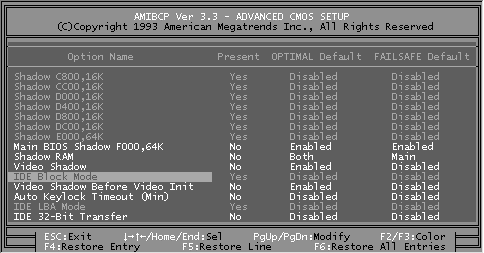

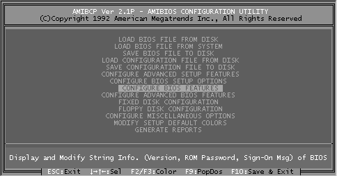

added a few screen shots from some old versions off a russian site(no did not check to see if they were already posted) and they did not have these versions....

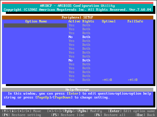

I'm usually using amibcp76 to modify pentium 4 era bios, adding updated microcodes and unhide bios options.
Sadly I noticed that those version seem to be a bit buggy, when open the bios menus they don't show then voice name and I have to unhide every option.
The resulting bios works but always seem a bit unstable.
Is there a version which supports those newer bios (2003-2004) without being amibios8?

As far as i know, you still have to use the dos utilities to open up those ones. Maybe a beta version of AMIBCP8 might read them but it's not likely.

I see. Well probably a version suitable to modify those bios didn't leave ami offices...
That's what I get with latest available amibcp dos version:
