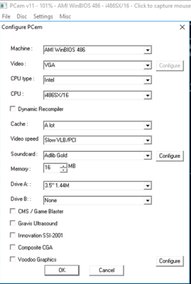

So, attached are the main settings I used. (You'll have to obtain/dump a BIOS & graphics ROM file, PCem doesn't come with them built in)
The Adlib Gold has the surround module enabled by default, but the setting to enable/disable it can be found in the Configure button next to the Sound Card dropdown when the Adlib Gold option is selected.
I created the hard drive with the default values PCem provides, which makes a ~251MB hard drive.
I then let it boot the first time. It prompted me with a message regarding the BIOS, but just entering the BIOS and save-and-exiting seemed to resolve that.
Then, I installed DOS, followed by the CuteMouse driver.
I installed the Adlib Gold drivers that can be found in VOGONS's driver library, and configured them (DMA 1, IRQ 5). The test built into the drivers gave me sound, but the left & right channels in the test utility seemed to be swapped.
I installed Dune, during setup it automatically picked up the Adlib Gold, and I was able to play it with the music. It does stutter a bit on full-screen, but as I mentioned earlier, I think that's because the CPU I selected is a bit too fast.

    The settings for my PCem config
