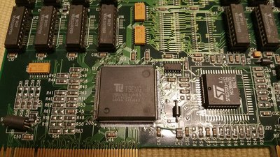

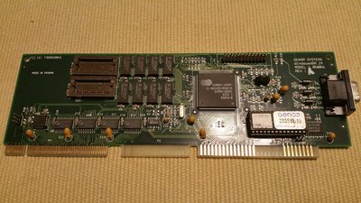

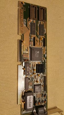

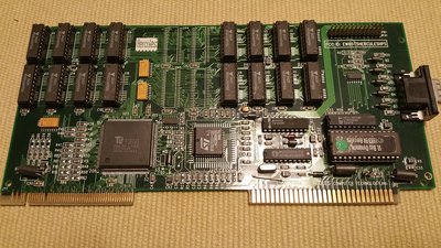

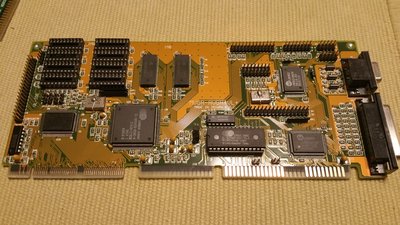

I've bought a few cards recently from scrap lots. i know more or less what I have but I' having trouble figuring out specs of these cards and in what systems they can go in.
Any help is greatly appreciated.

Looks like you have a Hercules Tseng Labs VLB et4000, another Tseng Labs VLB card and a couple Cirrus Logic xards. All good in 486 systems.

The Hercules card is either Dynamite D901, D902, Pro or Power (can't narrow it down more than that yet)
The Genoa GD5426 based card is an 8500VL, good for Win 3.1 with 24-bit colour
The bottom two I can't identify. The bottom card is interesting, I've never seen a VGA card with i/o device support 😀

The last one is apparently made by Prolink.
Here are the jumper settings for it
http://stason.org/TULARC/pc/hard-disk-floppy- … e-drives-M.html
Would you knew what chips I could put in the banks?
