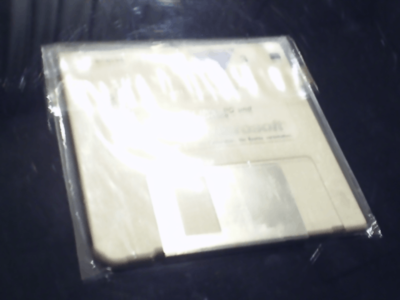

Hmm.. In my personal experience HD and DD types were often equally good.
I've got several 5.25" 1.2M diskettes which still work fine.
A proper storage is also important for the life time of a floppy, I think.
I assume you have used protective covers for 3.5" floppies like you did for 5.25" types. 😉
Besides, it is also important to keep the floppy drives clean.
A dirty drive will turn good floppies into bad floppies.
Oh, and please don't put 1.44M floppies into a low-tec Amiga drive.
That tape method never really worked.. 😉
    112.4 KiB
    489 views
    3.5 inch micro floppy with protective cover

How are we supposed to store floppies? If I simply leave them on my desk they all seem to die. I think they last longer if you store them in the paper box they came in, or one of those plastic floppy cases.

1.44MB disks work perfectly ok in the Amiga formatted to 880kB, but I have a 8MB upgrade board with CF card so no real need except some rare
game that won't load via WHDLOAD.
My opinion of what disks were good and bad has probably been formed by what I used, but probably what happened was that the cheap disks
produced in the mid 90's onwards really were poor quality and didn't last well. I remember paying $40 once for computec branded DSDD disks, after that
the price dropped to $20 then $10.
Floppy disk thoughts & questions
Long-term equipment/media storage
Where to buy new enclosures for 3,5" floppy disks?
Paper boxes and disk boxes are good, too.
Or simply use a fresh shoebox. 😀
About anything will do - just make sure 5.25" types get no pressure.
