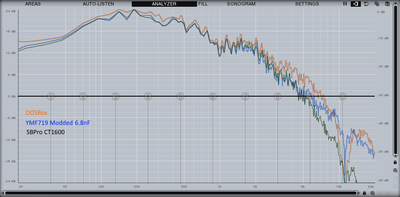

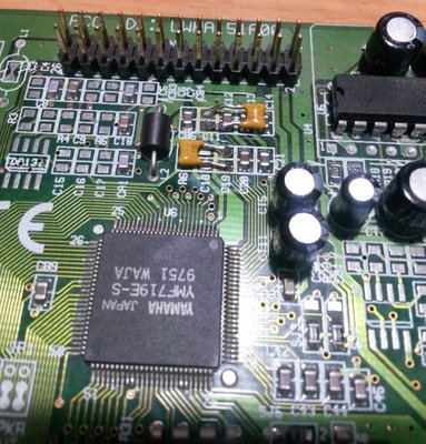

YMF71x Lowpass Filter FIX
Replace C11 and C19 (left and right) with 6.8nF capacitors, preferably 0805 (2012) 6.8nF SMD Capacitors.
This will make the YMF71x sound similar to the real SBPro which has a functional Lowpass filter, and now the YMF71x has too.
After many capacitors and frequency analysis I found that 6.8nF is the most accurate value and sounded closest to the CT1600 example firage provided, even closer than DOSBox.
So now along with the SB = 1 mixer fix and the modification it makes my Yamaha YMF719 the best DOS card I own.
89.24 KiB
5686 views
Note: the PCB image shows yellow 4.7nF caps which later were changed to 6.8nF.

No, it does not behave like the SB16 with a brickwall filter.
It behaves like the SBPro with a more mellow filter, you have a screenshot of a frequency analyzer above with 11khz samples form doom.

Reply 74 of 215, by clueless1
Are we talking about those two mica ceramic capacitors (yellow)? I thought those were considered through hole caps, not SMD caps. You've soldered them to the surface since there are no vias there, so yes, they are mounted to the surface. But they are intended to be through hole caps, right?
Reply 75 of 215, by James-F
Yes.
I used flux and made sure I don't cold solder them, should hold fine.
