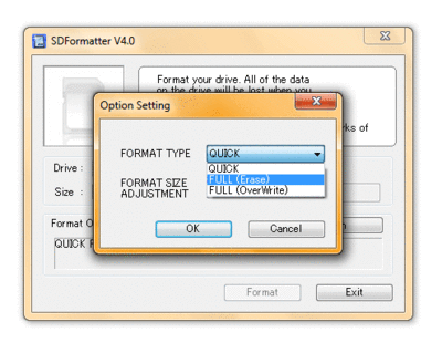

Apparently some SD cards do have something similar (see SD Formatter), but I've never seen a card with this feature. Did you ?
Edit: Several edits. Sorry. I can't concentrate myself today. 🙁

    Flash erase possible ?
Not that I know of, but I've never done much research into SD cards. If they do have some documented way to tell them to consider themselves erased, then that would be a great thing.
