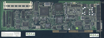

btw are you sure that the pictures are for CT2760? the ones I find on the net do not match?!
Reply 81 of 111, by Eep386
I believe there are two different revisions of the CT2760. The one I have, is for the 'older' first revision with the TDA1543T DAC.
265.08 KiB
2448 views
From yjfy.com
Sorry, I should have mentioned that. 😐

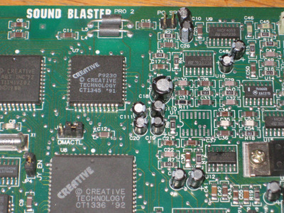

Reply 87 of 111, by Eep386
Well, darn. It looks like Creative's bad habits started before the Sound Blaster 16. 😐
I found that the upper half of the quad amp at U11 on a CT1600 Sound Blaster Pro 2 was floating too.
download/file.php?mode=view&id=100390
It's hard to tell but pins 8-10 and 12-14 are floating.
Thankfully this is the only quad amp on the board that has unused, floating inputs.
    537.76 KiB
    2392 views
Life isn't long enough to re-enable every hidden option in every BIOS on every board... 🙁
Reply 88 of 111, by gdjacobs
Eep386 wrote on 2021-01-16, 00:16:
Well, darn. It looks like Creative's bad habits started before the Sound Blaster 16. :| I found that the upper half of the quad […]
Sloppy. Strap those boys down!

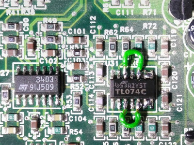

One more fault of many models of the SoundBlaster 16:
At least two models suffer from a rookie design mistake: unterminated (floating) portions of quad op-amps...
It's an interesting finding, it's a beginners mistake to leave floating opamp or CMOS logic inputs. I wouldn't expect this from a professional HW manufacturer. Maybe for floating-check it would be enough to use ohmmeter to measure resistance between output and input if there present some resistance of feedback network. Did someone checked AWE32 and AWE64 for this? I would look at my SB cards I have but guess AWE64 use only dual opamps.
I also wonder how many other bugs SBs have. In old good DOS days when I played games a lot I had ESS1868 with wavetable MIDI clone card and I didn't noticed any heavy disturbing bugs, also background noise was on acceptable level...
Gigabyte GA-P67-DS3-B3, Core i7-2600K @4,5GHz, 8GB DDR3, 128GB SSD, GTX970(GF7900GT), SB Audigy + YMF724F + DreamBlaster combo + LPC2ISA
Reply 99 of 111, by RayeR
I checked my old AWE32 CT3900 and I have found this 3 opamps:
U26: MC3403 - fully utilized
U27: MC3403 - fully utilized
U31: TL074C - part 2 and 3 are floating!
As the opamps are powered by symmetric +-5V I simply wired them as folowers with + input to GND.
