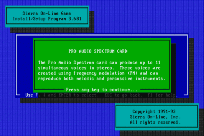

Thanks Phil! You're right about special support for the MediaVision cards.
Just checked, my copy of SQ4 does include Stereo FM support for PAS exclusively.
No SB Pro support is mentioned, just normal Adlib and Sound Blaster. And PC-Speaker, MT32/MIDI, of course.

    Space Quest IV - Stereo FM support for PAS (Dual OPL2 ?)
It doesn't say PAS16 though.
The original PAS was a dual OPL2 card, like the original SB Pro, but I believe the PAS was on the market first.
So it could be that they added support for Stereo FM before the SB Pro was available.
However, the original SB Pro is probably compatible with it (same chips, same addresses?). I think for OPL3 to be compatible, it needs to be switched into a 'dual OPL2'-ish mode first, so it might require a small modification to the game, or the use of some kind of TSR program to do that.
Edit: apparently this post has more information on dual OPL2 on SB Pro and PAS: Games with dual OPL2 support for stereo FM?
Sounds like the SB Pro and PAS aren't directly compatible, as the second OPL2 is at a different address. Aside from that, you need to reprogram the mixer manually, which also wouldn't be compatible. Still, with a few small changes, it should be possible to make it work on both dual OPL2 SB Pro and OPL3 cards.

Hardware Mod
I only have a PAS16, and in that game, you get nice Stereo FM 😀
In many other Sierra games, like Police Quest III, you really need to dual OPL2 PAS for Stereo FM.
