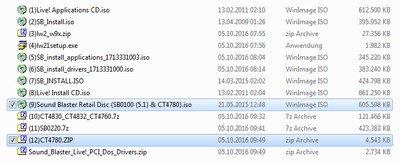

Reply 4 of 6, by Roman78
I 'R prepared..... 🤣
26.2 KiB
540 views
Think have best results whit package 9 and 12, because the SB0100 is especially mentioned in those two.
