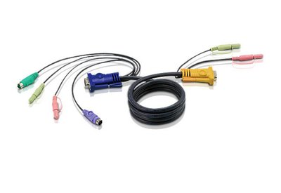

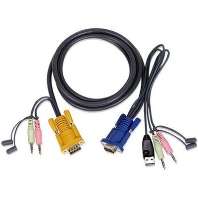

I suggest Aten CS1734B. It has 4 ports, support for both PS/2 and USB, have standard cables for both USB and PS/2 computers (you might need to buy PS/2 cables as spare parts), support for speakers and microphone. I'm using mine for the last 5 years or so without problem.
As an additional suggestion, use separate USB keyboard and USB mouse for the KVM (I mean your console). Composite devices with a single USB transmitter for keyboard/mouse sets causes problems. And your USB mouse must have PS/2 support, for your older PS/2 machines to sense the mouse connected to the KVM.
In short, just find a separate USB mouse (with PS/2 support, newest models don't) and a USB keyboard, and connect them to the KVMs respective sockets. Find enough KVM cables:
33.16 KiB
973 views
For PS/2 (=older) computers
31.95 KiB
973 views
For USB (=newer) computers

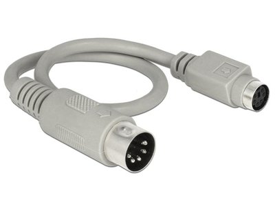

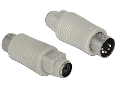

And use one of these AT/PS2 adapters for keyboards:
21.15 KiB
973 views
20.9 KiB
973 views
