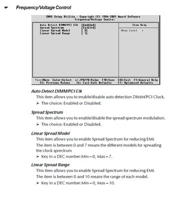

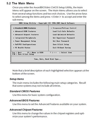

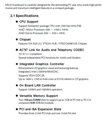

I had a look onto the manual of the board you mentioned. The Shuttle MK20. The manual has version 1.0.
You have mentioned also the revision 1.2, but i don't think that the result from the following is really different to Rev. 1.0
The Shuttle MK20 has a Via KLE chipset.
http://www.motherboard.cz/mb/shuttle/MK20.htm
The BIOS is from AWARD, and what you can see in the manual is that you cannot change any multiplier in the BIOS. Compared to SS7 boards you also have no jumpers onboard.
Even when you go for the pencil trick you have no chance for multiplier change.
The only way is maybe, to flash an alternative BIOS if available and with the settings you need.
Or maybe a hardware PIN-mod, if possible for T-Birds... Don't know if the 2x would be available you mentioned. Mainly the first multipliers for Via's KTxxx mainboards will be 5.0 and higher.
