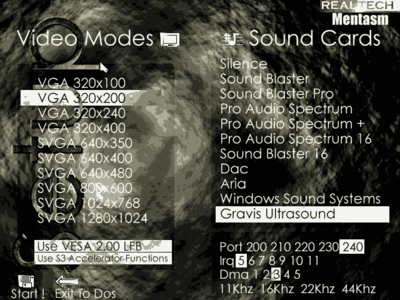

But if this still doesn't work, you could try to run NSSI and get some information about the card and perhaps even make a BIOS dump.
Another idea is to run a demo with S3 support, like Countdown by Realtech. It claims to have native support for the S3 cards and allows
the selection of different resolutions.

Jo22 wrote:
Hmm... That's indeed a strange issue you've got. Never had serious problems with a Trio myself so far. If it is similar to the c […]
If it is similar to the card in the link, you could try to change the jumper setting (the jumper is "hidden" near the VGA connector).
Ill try to find this program and get some testing done.

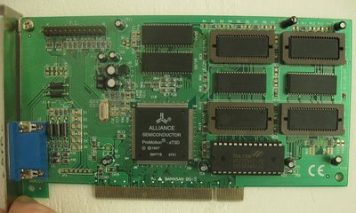

Reply 14 of 16, by kanecvr
It takes regular video ram chips - like what's socketed on most PCI cards:
180.27 KiB
669 views
If you have any video card with socketed chips like the ones above, you can remove them and place them in the sockets for the on board cirrus logic. Just make sure not to put them in backwards - the dot on the side of the chip should match the notch on the outside of the socket, like in the picture above. You can also de-solder chips off dead cards.
Reply 15 of 16, by escarioth
oooh really ? i do have 2 s3 video cards both with chips in their socket, ill try removing 2 of them 😀
even if they're old....those old dos games are still the best!!!
