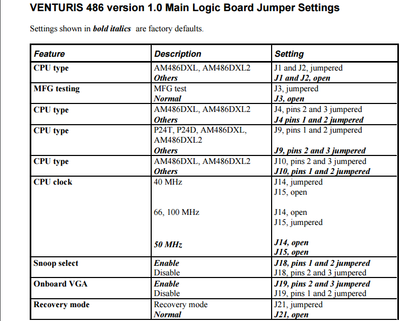

Well it didn't post but I'm not getting discouraged yet. I had this issue when trying the dx4-100 and I figured it out.
Here is a pic of the manual from '95. What jumper settings would you guys choose for the POD83? I'm thinking Other since this board was always meant for AMD cpus not Intel.

Reply 5 of 7, by TheMobRules
Pentium Overdrive 63/83 = P24T, so go with that setting on "CPU Type" jumpers. For the rest I assume you could choose "Others", and then 66/100MHz clock which I assume means 33MHz bus.
Reply 6 of 7, by bbhaag
Thank you for the help. Your suggestions worked and it posted and loaded 6.22+WFW3.11.
