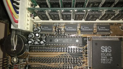

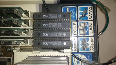

I have attached the pictures of the jumper settings....
    212.54 KiB
    1804 views
    Jumpers for CPU settings
    198.27 KiB
    1804 views
    Cache jumpers
    150.77 KiB
    1804 views
    Cache chips installed

Just noticed something....
Is my board with 512kb cache installed? According to the manual, it can take eighter 128 or 256kb.
Can the board run without cache? If so, shall I take out the tag and the four cache chips to test?
    52.29 KiB
    1784 views
Reply 9 of 30, by Imperious
According to the datasheets You have 256k cache and 16k Tag installed.
