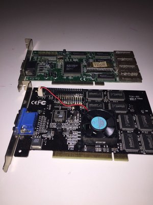

I Bought these Yesterday, likely they would be gone by now anyway though. I don't think the seller realised the bottom one was a PCI Banshee card. I hope that is
just dust and not corrosion in the Virge DX memory slots. $45 AUD delivered.
Nice. I've found a lot of really really awesome deals on rare PCI cards, especially Voodoos that way. I got my PCI V5 5500 in a lot of mixed as-is parts for around $40 last year. I replaced one or two SMD caps and it works great. Same with my Quantum 3D Raven PCI (16MB Banshee)... it was hanging out shyly on the edge of one picture in a lot of mixed cards. I almost missed it because I was distracted by the SBPro2 CT1600. Again got that lot for a fraction of its value.
Looking for video cards, without searching for "PCI" seems to be the ticket. With patience, they turn up eventually.
