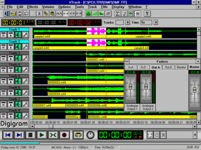

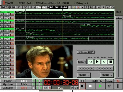

Reply 17 of 20, by lolo799
Digigram made ISA cards (the early PCX series) with DOS drivers, along with audio editing software such as Xtrack:
57.13 KiB
621 views
53.32 KiB
621 views
Screenshots from http://www.uni.net/logicaltools/xtrack.htm
