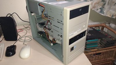

All right.... This is my new build.
I had an 5x86-133 setup wich was beginning to run really unstable, so I got an Lucky Star ls486e C2 instead.
I have just finished this new build a couple of minutes ago, and I think this is running a bit better.
I wanted to aim for eighter an Dx2-66 or Dx2-80 on this build, though I can not get it to run with 3v CPU's.
The previous owner have promised that it will work with 3v CPU's, and I guess I will eventually figure it out.
I think that I am the one to blame, and that there is nothing wrong with the motherboard at all.

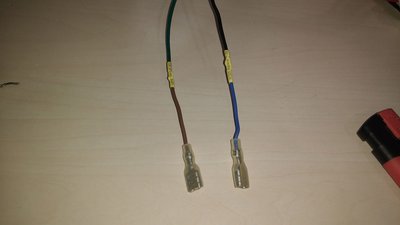

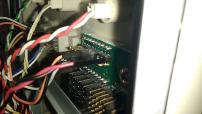

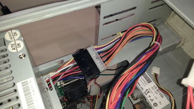

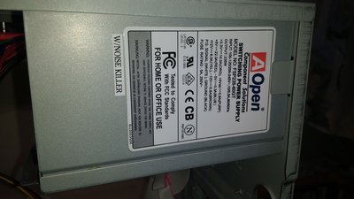

First up. I have used a good ATX power supply from A-Open. With this I have used a simple ATX to AT converter.
I have modded the power-button cables with somme bigger plugs, because the case button's terminals were too big.
So I had to do some soldering today.... Fun. 😜
I have attached all images as inline, so a bigger one can be chosen by clicking on them.
98.91 KiB
613 views
Solder work done.... Quite happy with the result.

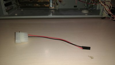

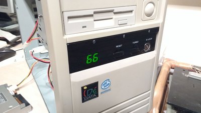

Then I turned my attention towards giving power to the fronpanel led. I modded the led, in order to show 66 and
then I used this cable to give 5 volt to the led. Originally, the power came from the PSU it self.
47.21 KiB
613 views
All set correct up, and connected with the cable.
81.89 KiB
613 views
Working correctly....

Reply 1 of 10, by brostenen

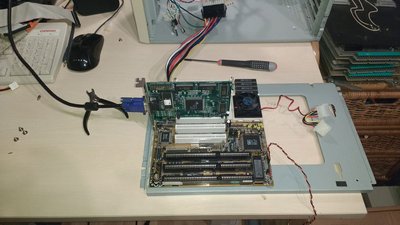

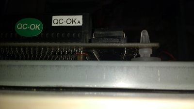

When mounting the motherboard, I had to use two of the red paper washers. One under and one on top of the board.
137.81 KiB
606 views
45.04 KiB
606 views
Then I tested if it would boot, mounted on the plate, before reattaching it to the case.
110.6 KiB
606 views
Success..... Mounted, and began with the rest of the build.
104.63 KiB
606 views
Reply 2 of 10, by brostenen
Last flood of pictures..... 🤣

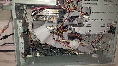

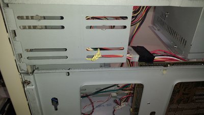

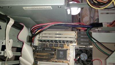

I had to mount the ATX to AT converter, in order to not having stuff blocking the CPU fan.
And being fresh out of zip-ties, I used a piece of wire. Not beautifull, only effective. 😁

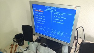

The build is done. I installed missing drivers and did some basic testing.
Doom runs fluid, Jazz rabit runs smooth and Duke2 are running great.

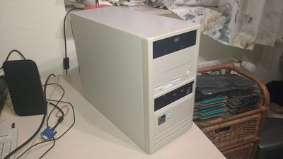

Reply 3 of 10, by Tetrium
Your system looks very nice and simple. How is it working for you? Any particulars about your CL graphics card? I never got to try out one of those early CL PCI cards, don't even know if I have any.
Your case, does it still have its u-cap panel-thingy whatever are they called?

The new ATX is more silent and delivers 5 watt more on the 5volt rail. 😜

Reply 8 of 10, by brostenen

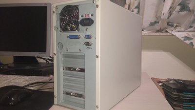

Ahhh.... The case cover? Shure I have that too. It's all original. I got the case from my parents originally.
It contained their second pc. (P133, 64mb, Ati Rage Pro, SB16)
Well... Don't be sorry. English is my second language, so I know how it is, not really knowing a specific English word. 😉
Anyway... Some more Pic's, since you asked about the cover.
82.91 KiB
441 views
71.43 KiB
441 views
