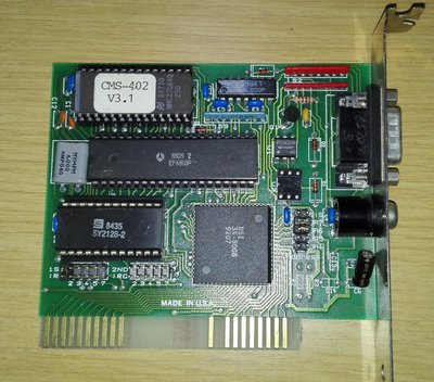

i'll take advantage of this thread and i'll ask... what the heck is this card?
Taken from a really old 286 ages ago, along with a Paradise Vga.
I'm guessing it's an audio card ? There's an rca output (or input?) but why the serial port?
647.06 KiB
331 views
Reply 8 of 11, by Ozzuneoj
It says CMS but it doesn't look like a Creative Music System to me.
I agree that it's probably an MPU401... No other markings on it?
My Midiman MM401 has a DE9 for midi in/out and a single RCA jack for a metronome output, much like your card.
Reply 9 of 11, by mongaccio
h-a-l-9000 wrote:
It has all components a MPU401 card would need.
Many thanks it's a good start, i'll try finding the 'serial port' pinout now.
And no, no brands or markings excluding the Eprom version and the 'made in usa' logo
Reply 11 of 11, by gdjacobs
Apparently the company was "Computer Music Supply". Adverts posted in a 1989 edition of PCMag.
https://books.google.ca/books?id=h6qtgYAzqDgC … %20card&f=false
This is likely a revised version of the CMS-401.
