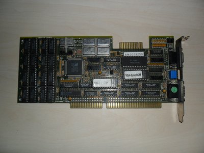

Hi.
I am sitting with this mysterie card. All I know is that it is an ET3000 and I can get an image when using it.
1.14 MiB
445 views
There is no real markings or anything on this card, in order to identify the maker, the model number or
anything else about this card.
Because of this, I do not have any manual or anything that can leed me to the jumper settings and to
the dip switch settings.
Drivers are no problem getting a hold on, as they are all over the place on various FTP servers.

It looks like this one:
http://www.amoretro.de/2012/07/tseng-labs-et3 … -512kb-isa.html
I guess jumpers would be the same as on other similar ET3000 based cards.

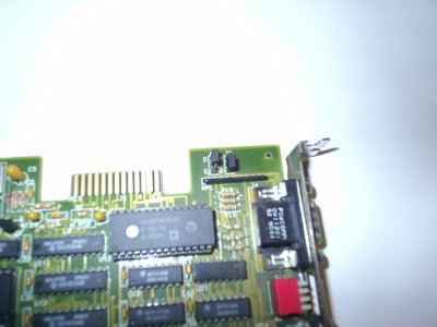

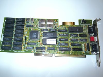

Hey, that card looks familiar! I think I've got the same (in working condition). I'll check after weekend. 😀
Edit: I had time right now and captured some photos. The card works in its current configuration.

It deos look like it's the exact same model...
However the page does not provide any info on the settings and maker. 🙁

Seems like a fairly common 3000 card. Just a shame that I can not find documentation on them dip switches.
One jumper is for IRQ selection. No question about that. Yet the rest! Hmmm....

I'd assume the DIP switches are using the default order as on most EGA/VGA cards.
I have a very similar model from Ara International Co. Ltd. http://retronn.de/imports/hwgal/hw_graphics_c … 00ax_front.html

If you look at my picture the DIPs are set to OFF OFF OFF OFF which is the VGA configuration. If you doubt the settings plug a EGA Monitor and change DIPs to EGA config. If you get signal then this DIP config is working as well.
Be aware that some cards feature EGA/VGA monitor auto detection, so plug only EGA for this test.
You can go on if you have a IBM monochrome monitor...
In normal VGA operation with a multi-sync monitor only OFF OFF OFF OFF is relevant.
