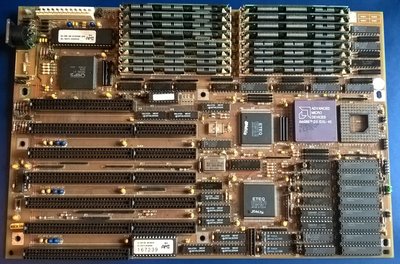

I recently got this AMD 386 DX-40 equipped motherboard. It has some acid damage, and seems to be missing some cache chips? I can't get it to POST. No image with two different video cards (both know to be good in other systems). No POST beeps 🙁
Does anybody recognise it by any chance?
Is the cache required or should I just pull out all the chips to test?

It is the soyo-SY019I:
http://retronn.de/imports/hwgal/hw_386eteq.html
NPU is detected automatically.
Actually not many jumpers there.
You board misses a few ICs.

Thanks elianda! How did you figure it out? I seem to be missing some of the cache chips and also U23 and U24 (the setup of those seems a bit different on that (your?) site). I'll try and move around/move the cache chips to see if it makes a difference.
It might also just be dead 🙁
Well, there is a 019I sticker on the board.
http://stason.org/TULARC/pc/motherboards/S/SO … 9H-SY-019I.html
It looks like your board needs some work.

Nah, it doesn't look that bad. Don't throw it away yet.
Often removable ICs can be found in electronic stores.
And damaged traces can be replaced by a few patch wires here and there.
I mean, what do you have to loose ? If it's already dead, nothing is lost.
But before you do, please use a cheap diagnostic card or a beeper and check for signs of life.
That's better than damaging one of your precious VGA cards.
PS: Normally, broken caches should't prevent it from starting.
They aren't used until they were found to be good.

Jo22, beeper gives no sound, and I don't have diagnostic card (yet). Any recommendations for one? I have about 16 Socket 5 and 7 board to test soon 😀

Looking at the battery damage again, I feel it should be fixable if/when there are problems. But then there are the missing chips... There are a bunch of cache chips missing, those are replaceable but expensive on eBay. I have little experience with this, is there a guide on cache chips somewhere? I have plenty of 486 boards that might be able to donate some chips for tests.... Can I just leave them out? Will the board at least POST without them? I haven't tried anything yet, because:
On to the real challenge: there are two more chips missing:
elianda has a picture of the board on his site here: http://retronn.de/imports/hwgal/hw_386eteq.html . Besides the cache chips, U23 and U24 seem to be the two empty sockets. Enhancing the picture shows
U24: 74FCT / 521BP(triangle) / 9131CP
U23: P9142?? / 74FCT24?? / PC
I can probably 'just' find these on eBay and go for it?

Yes, these are standard logic ICs? You can also use other types, i.e.
U24: 74ALS521 74F521
U23: SN74HC240 74ls240

Just a quick note, HC and LS series might be a tad bit too slow for this task, if it's cache memory related. Mouser should carry FCT but you can try substitutes too.
I'd pick ACT for FCT replacement. If you can't find ACT, try AC first, then HC/HCT, then ALS and LS as last resort.

Thanks for the explanation! In the end, I found FCT versions for acceptable prices (well, acceptable if you include the fact I buy one and they need to be shipped).

Now it hangs at the post screen. Tried some cache from another board, still hangs. Keyboard is working after a hard reboot (I can CTRL-ALT-DEL), but after a reset/CTRL-ALT-DEL the system becomes fully unresponsive. 🙁

No, I can't unfortunately. I also tried without any cache chips (and TAG). Same behaviour...

I also tried with a controller . It has been sitting like this for at least 5 minutes sometimes. POST card displays --, it does not show POST codes at all on this board. I am going to try another PSU this evening, swap the RAM and also checking some traces near the keyboard connector. Not really sure that will help.
