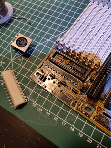

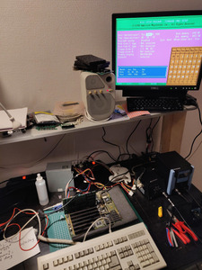

Another update! And finally the board seems to be working completely! Today I decided to look at the board again and to do some more de-soldering and analysis. Since I still suspected the problem to be related to the (little) acid damage near the keyboard connector, I removed the keyboard connector and power connectors. There was some acid staining, but everything was checked with the multi-meter and everything had continuity.
1.33 MiB
75 views

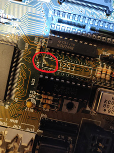

After that I did a thorough visual inspection, and something underneath one of the sockets with the previously removed logic chips caught my eye. I removed the socket and:
1.11 MiB
75 views

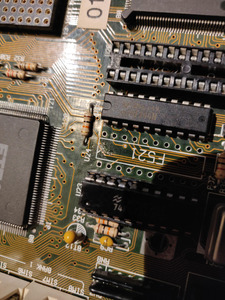

Luckily I have been watching a few RetroRepairs videos in YouTube so I knew what to do:
1.24 MiB
75 views
And after reassembly she seems to work a lot better!
1.19 MiB
75 views
So happy to (hopefully) finally close this repair project.
