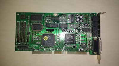

Tested this today and I can not understand why there is no FM (Adlib/OPL) playback on the right channel.
Anyone here that can confirm if this is right or wrong?

the OPL2 Adlib FM music is played back on both channels. You you use the right driver for your chip revision (FF)?
Maybe there is a contact problem? Does it play back on one speaker also when you switch from line-out to speaker or vice-versa?

It has missing jumpers - it should have a jumper that sends midi to both channels if I'm not mistaking.

Should be the right drivers. I found the drivers on an ftp server, in a folder that stated this to be the right ones.
There are problems with the right one missing, using both speaker and line out.
Missing jumper? Hmmm... Do you have any information about jumpers on this card?

Good observation! Didn't spend the time looking closely enough! I agree, there is one jumper missing next to the one installed at the slot-side.

Unfortunately not, but it was common practice on some old cards to have jumpers for setting stereo/mono/single channel output, as well as enabling the amp, line in or microphone.

Looking at this, it seems like my card has jumpers the right place.
http://www.amoretro.de/2012/04/mozart-wave-ta … etable-2mb.html
I think the drivers might be an issue. Do anyone know a place to source the right ones for me to try them?

I can confirm that the jumpers shown on my HP are set correctly. So it might be something different.
Here is a FAQ and some drivers: ftp://soporte.uson.mx/DRIVERS/AUDIO/mozart/AUDFAQ~1.HTM

SOLVED!!!
Oh my freakin..... 😳
I just purchased two cards that will not function propperly in a P-II-350 system. What gives?
I swapped the machine out for my 486 system, and behold, it works.
Running the Mozart Wavetable on a P-II-350 (Asus P2B-S), is just too fast a machine.

That applies to many cards. Speed sensivity - be it from hardware or from the software side. Looks like we have another card to add to this lists (just gives me an idea of creating such a list..)

It's not necessarily the P2 - it's most likely the motherboard.The non-opl4 Mozart I sent you runs perfectly on my Abit BE6-II (440bx) with a 333Mhz P2 overclocked to 500MHz.
Glad you figured it out. That mozart card is awsome. It has the Yamaha OPL4 wavetable synth witch not only sounds incredible, but is General Midi compatible so it will work in most games w/o issue. I've been hunting for that exact card for a while now - if it sounds half as good as my Yamaha SW20PC, it's definitely a keeper.

Nope, the Mozart Wave tables OPL4 part is not compatible with DOS. DOS games only see the OPL3 part of the chip. The same applies to Miro PCM1 Pro and PCM10 OPL4 cards.
