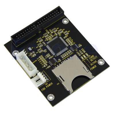

Reply 1 of 5, by Jepael
Maybe the IDE-to-SD adapter is not acting like a real hard drive. So maybe it is the same thing interfering with floppy disk change signal that exists with CF cards. Reading port 0x3F7 that is.
If you change to real hard drive, does it fix the issue?
Or change the IDE-to-SD adapter to secondary IDE port?
You know, you are on to something. I hadn't yet tried to just use the SD card and adapter without Ontrack and just formatting it to the 489MB the bios can use, but now that I do I notice I get the same problem.
So the reason it worked earlier when I booted from a boot disk must've been not because the Ontrack overlay didn't load, but because the computer didn't see the SD card at all without it?
I have the most common SD IDE adapter from Ebay (see picture).
I haven't tried a real drive yet, but when I use my CF IDE adapter with a 512MB CF card it all works perfectly, and I can change disks on the Gotek just fine.
So my CF adapter works, but the SD adapter does not, probably?
Unfortunately I only have one ISA controller card, and it only has a single IDE connector. I might try it in my Pentium III system tomorrow and see what happens there. I'll try to find my old 6GB IDE drive as well, just to confirm that other types of drives are working fine like the CF adapter.

    SD IDE adapter
Reply 3 of 5, by Jepael
I don't know why it worked, maybe there are extra checks when booted from a disk.
Not really, because CF card adapters are passive, so it might mean the CF card is actually emulating a hard drive correctly. What brand/model is it?
But the problem might not exist on the P3 motherboard if it has hardware workaround for this. The IDE port is connected more directly through chipset IDE controller, while floppy may be through legacy ISA bus. Not a comparable situation.
One workaround here on Vogons suggested to load drivparm in config.sys with parameters to ignore hardware disk change signal.
