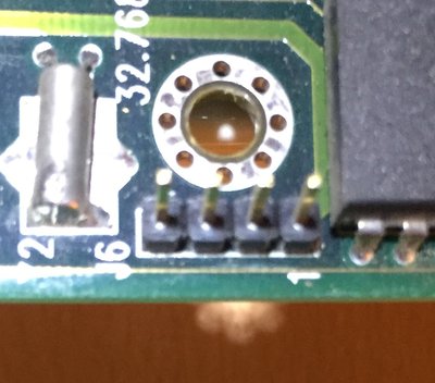

My 486 motherboard had a soldered on rechargable 3.6V battery, but it was removed so it wouldn't leak. I was adviced on this board to mount an external battery if possible, and it looks like it is possible. However, I'm a bit confused and need some more advice.
My board is very close to this one:
https://th99.bl4ckb0x.de/m/C-D/34280.htm
It's not 100% identical as some jumpers are placed differently, but it seems to be close enough.
The J6 is the connector for an external battery.
207.29 KiB
1577 views
It looks like only pin 1 is connected to anything. Am I correct in assuming this should be soldered to the plus side of a battery holder? Shouldn't the minus side be connected to anything?
On the back of the board nothing except the soldering blobs are visible.

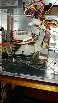

I have the same setup on my 486. I ended up jury-rigging this:
1.3 MiB
1558 views
I took a PC Speaker cable and cut the speaker off.
Then I desoldered a coin battery cradle from a spare dead motherboard.
I soldered the cable to the leads of the cradle. The connector on the cable plugs right into the battery headers and you just drop a CR2032 battery into the cradle.
That's just one way of doing it. Mine looks kind of ghetto, but it works.

The internal and external batteries are more or less guaranteed supposed to be connected in parallel. Just do continuity tests between the internal battery poles and each pin, and you'll find out which pole of the external battery to connect to which pin 😀
Any .10" hole pitch connector will do, the suggested CD audio connector for instance. If you don't have one of those, you could always trim down a spare IDE or floppy cable to size.
Multilayer PCB. The dark green (vs light green on the edge of the board) is copper of the inner layers. The ground pin will be connected there.

Reply 7 of 10, by c0keb0ttle
Thanks for all the responses guys!
I confirmed with a multimeter that pin 3 and 4 both were connected to ground. The internal and external batteries are not connected, there is a jumper that switches between them. This is fortunate, because the internal battery is rechargable so there is a current supplied to the pins, but not to the external battery which meant I could use any kind of battery.
I used an internal speaker cable and soldered onto it a CR2032 holder. I'm not very good at soldering, so it looks like some kind of Frankenstein's monster contraption, but hey, it works like a charm! 😀
