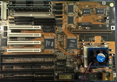

I recently acquired a "new" Pentium 1/Socket 7 system, which came in a really nice AT case including a 5,25" floppy drive for around 30€.
Inside was a Soyo 5TE2, now I have a buttload of good and excellent Socket 7 and Super Socket 7 boards (Tyan, Asus P5A(-B), P/I-XP55T2P4, GA-586HX, GA-586ATS and so on). Is this 5TE2 any special or is it just another Socket 7 board?
The Dallas module is socketed, thats a plus. However I would also have the equipment to unsolder it and place a socket there instead.
The case + 5,25" floppy drive would perfectly fit for my 286 project, so I'm not gonna use the Soyo board.
The question is now: sell it or even throw it away (if it is a really crappy board) or keep it?

Reply 1 of 8, by melbar
Have the same board. Got it also with an AT case, but the condition of that case was really bad so i've scrapped it.
Recently, i thought to sell this board, but now i want to re-built a (non super) socket 7 system.
The chipset is the first Triton (430FX). Disadvantage is: you cannot use any MMX -CPU cause there is no voltage spliting.

Reply 3 of 8, by kanecvr
Soyo boards are generally fast, stable and reliable. I have a lot of soyo boards ranging from 386 all the way to Socket 370, all working, all well above average. If nothing else this board is very reliable and makes a good backup part.

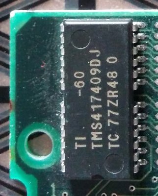

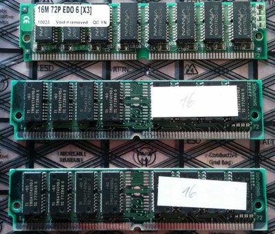

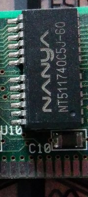

During my test's today with this socket7 board (soyo 5TE2) i am little confused. Maybe somebody with more experience regarding FPM RAM or EDO RAM can help me.
I've bought these three 72pin (should be EDO RAM) with each 16MB capacity.
  • - 2x Texas Instruments TMS417409DJ -60
    - 1x Nanya NT511740C5J -60
First, when i put only one single RAM in a slot, it doesn't boot. Only with two pieces of RAM it boot. Why?
Second, if i install only two, doesn't matter which of the above mentioned, it shows 32MB ram. Alright it's OK.
But when i install all three, it shows again 32MB.
Have also some old 4MB 72-pin RAM's and for example when i install 2x16MB + 2x4MB, i'll get 40MB on the post screen.

Reply 7 of 8, by Tetrium
melbar wrote:
First, when i put only one single RAM in a slot, it doesn't boot. Only with two pieces of RAM it boot. Why? […]
You have to use pairs of memory modules as the SIMMs are 32 bit and the Pentium uses 64 bit memory access (please remember I'm not a technical guy).
I don't remember if one could mix EDO and FPM on the same board, but the pairs of memory modules you use, best is to use as identical pairs as you can scrape together.

Reply 8 of 8, by melbar
Thanks for the info's.
Problem solved !!!
The old SIMMS's i had, one from NANYA and three from NEC, has shown 16Mb of RAM on the post-screen.
Now, i have tested again my old NANYA SIMM with the NANYA i've bought the last week and the result is: 32Mb RAM 😀
So, according to these tests, the best is to use SIMM's with equal size, cause pairing two different SIMM's you loose some memory!!
