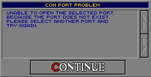

Reply 7 of 24, by Peyre
Yes, basically. I'm using D-Fend 2 as a GUI for DOSBox, and I had D-Fend enable the modem. When that didn't work I think I also manually modified the .conf file--still no go.
I had the same problem in both Win98 and Win2000, both with external USR 56k faxmodems. And yes, both were on at the time. 😉

Reply 9 of 24, by Peyre
Yeah, that makes sense. I may have misread that part of the readme.
In any case, BARIS yelled at me when I tried to use modem multiplayer--either hosting or joining.
Reply 10 of 24, by Peyre
Funny--I just tried it on a Win98 system that runs BARIS natively (ie, no DOSBox). I pointed it to the correct Com port, and it still gave me the error! Maybe this is a bug in BARIS, not a problem on DOSBox's end.

Reply 12 of 24, by Peyre
Uhhh....I'm not sure I follow you. I'm running the latest version of DOSBox (v. .63). And I have the problem even when I'm not running DOSBox at all. 😕

Reply 16 of 24, by lwc
Let me try and stop the confusion: our friend Peyre just tries to say that if it doesn't even work without DOSBox, then there's no way it would with with DOSBox.
Then again, Peyre's screenshot didn't tell us which port "does not exist".
But more importantly, Peyre is the only one here that talks about an actual modem. The rest of the posters talk about DOSBox's infamous fake modem which phone number is actually an IP address (i.e. it turns old games' modem support into TCP/IP [read: Internet] support).
...assuming DOSBox v0.63 does work with dotless IP addresses, as that is what started this whole discussion in the first place!
So Peyre, if it's a fake modem you want, just try running the game through DOSBox and enter your friend's IP address instead of his phone number. Of course, this is assuming he runs the game through DOSBox too and both of your firewalls accept outcoming/incoming connections (the latter at least for the host) from the port that is mentioned in your two DOSBox's configs!
However, if it's a real modem you're after, that's a whole other setting in DOSBox's config. But nothing would work until your modem works successfully in Windows natively! Start by entering its properties and check for its port!
Hope I cleared up the mess...
Reply 17 of 24, by Guest
LWC, that's correct--even when I run the game natively in Windows (on a computer that doesn't even have DOSBox installed), I still get the error.
I get the error regardless which Com port (1-4) I select in the game, regardless which I select in DOSBox/D-Fend2, and apparently regardless which physical Com port the modem is on (Com1 on my machines with DOSBox, Com2 on the non-DOSBox computer).
The modems work on all three computers; all three systems are able to dial up to the Internet when our high-speed Internet connection is temporarily down (yep, you guessed it, I have DSL). 😉
The thing is, what I'm actually trying to do is the IP address thing, but I get this error before I'm given a chance to enter a phone number. (I was working with the physical modem & Com port just so I could get to a window that would let me enter the number.)
Is there a place in DOSBox itself where I'm supposed to enter the IP address? Am I missing something? Or am I doomed to failure (drum roll!) with BARIS since it chokes before allowing me to enter the IP?
Reply 18 of 24, by DosFreak
Hmmmm, interesting. You say you have a 98 machine. Can you try it from real MS-DOS instead of Windows 9x command prompt?
If it then works under MS-DOS (not 9x command prompt!) then that would be very interesting. I only have a demo version of the game...heh....it actually is a DEMO all it does it show what the game will be like sort of like a movie trailer.
