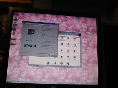

Reply 20 of 28, by yawetaG
Yamaha utility:
151.6 KiB
1027 views
System Settings box, finally showing proper RAM in Windows:
166.41 KiB
1027 views

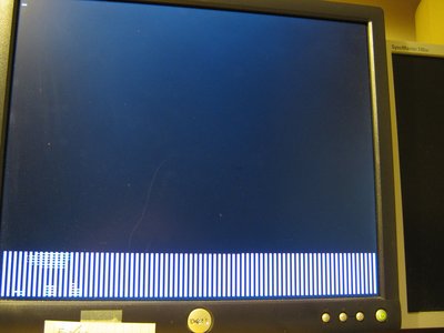

I suspect the SiS integrated video or its driver doesn't play nicely with the power management features, as the video-related problem occurred right at the time the Windows 98 power management setting were set to sleep the monitor. It looked like this:
123.66 KiB
1027 views
I already disabled most of the power management in the BIOS, and will disable the rest of it soonish.
The video is nothing to write home about. Besides buggy video modes, any animations in Windows are rendered very slowly, while anything requiring an immediate change works fine. The darkening of the screen when selecting the Windows shutdown option in the Start menu takes 1 or 2 seconds to complete and looks like a tidal wave moving over the screen 🤣 Then once the dialog box is displayed it looks like the refresh rate of the background image becomes unstable. The system has DirectX 5 installed:
140.37 KiB
1027 views
I don't want to know how DirectX games run, I just don't want to know... (I guess they'll crash) 😵
Any recommended video cards, besides a Voodoo? Edit: Started a thread for the VGA card.
And suddenly all becomes clear...
All of the power management issues are chipset and video driver related, and occur in combination with Windows 98, sometimes specifically the Japanese version of Windows 98, according to the Release notes of the updated SiS chipset and video driver set I just downloaded from their website. For example, the issue described above is this one:
<Title>: When waken up, there has black bars at the bottom of screen <O.S.>: Win98 Japenese <Description>: 1.)Enter win98 Japane […]
<Description>: 1.)Enter win98 Japanese version, press the hareware "standby".
2.)When waken up the system, there has black bars st the bottom
of screen.
(Engrish courtesy of SiS 🤣 )
Also included: many more crashes involving standby and power saving modes, both in Windows and MS-DOS mode, DirectDraw fails, corrupted graphics in PDF files, and the media player changing to pink hues when a video file is played from CD and the CD is subsequently ejected 🤣 I'd love to know what caused the last one...

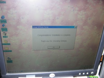

However, with a working CD-ROM drive, I now could install the drivers for my USB ZIP drive:
92 KiB
889 views
105.72 KiB
889 views
The drive works, even though the Iomega installer complained about an unidentified issue with the USB controller chip that means using more than 1 USB device at once will make the system unstable. Fortunately I won't be using any other USB devices on this system. So the next step was to deflower this virgin pack of 250 Mb ZIP disks:

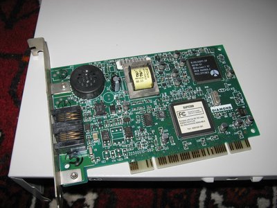

Then, I disconnected all cables, opened up the case, and pulled out the PCI fax modem for which I lack the drivers:
187.82 KiB
889 views
To replace the fax modem I will install my old Adaptec 1520B SCSI controller.

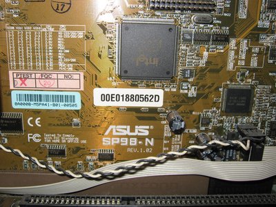

Reply 24 of 28, by yawetaG
But first, another look at the motherboard, more specifically the part that was hidden by the fax modem until now:
306.2 KiB
888 views
So motherboard version 1.02, with support of AMD K6 processors up to 300 MHz 😲

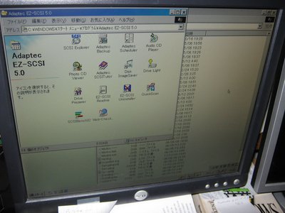

Then came the software installation part. This was a pain in the behind, because Adaptec's EZ-SCSI installer is ass-backwards and insists on installing the drivers from floppy, even if they are already present on the hard disk. The system itself has a latency issue regarding accessing the floppy drive and CD-ROM drive at the same time - you have to give it time to read the floppy, otherwise you are greeted with read errors (and sometimes system lock ups). 😐 Finally I figured out that the most recent sparrow.sys driver was, in fact, Iomega's Jaz driver for a Jaz-adapter card (could it be that the USB ZIP drives are actually SCSI-over-USB?). After letting Windows install that driver by itself, I could finally install EZ-SCSI properly, at the end of which I was greeted with this window:
130.04 KiB
888 views

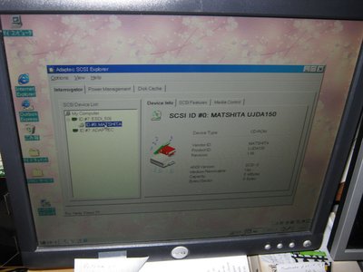

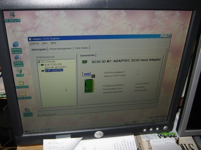

And then I checked out the SCSI exploration utility, and was greeted by this:
107.49 KiB
888 views
Two SCSI adapters 😲 . One of which has the CD-ROM drive as a SCSI device:
114.41 KiB
888 views
Note the SCSI version: SCSI-0.
Now the CD-ROM drive is a PATA slimline drive that somehow exists besides the two main IDE channels, yet does not show up in Windows Explorer when no CD is inserted. I guess this explains how that's possible; it's hooked up to a PATA-to-SCSI bridge transforming it into a SCSI device that depends from the motherboard's hidden SCSI controller. Then the only thing the optional Asus-specific PCI SCSI card does is to provide external connectors to the integrated-but-almost-fully-functional SCSI controller...

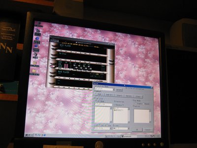

Regarding sound and DOS: Restarting in MS-DOS mode via the Windows shutdown menu results in the Yamaha setupsa configuration utility popping up, being controllable via the keyboard for a short moment, and then hard-locking the machine. Starting setupsa from within Windows also hard-locks the machine, and starting it from MS-DOS mode after booting directly into DOS fails in the same manner. 😵 Can the integrated OPL3 soundcard be configured without using setupsa?
Within Windows everything works as expected, there's a MIDI-to-FM driver too.
Edit: Oh well, screw DOS games, who plays those anyway? 😉 Let's make it a MIDI-music producing monster: Right now I have installed Cubase Lite, Voyetra Orchestrator Plus, the Yamaha CBX-T3 serial driver, Karaoke software, Yamaha software players for IE, Adobe Acrobat JP, Japanese Singer Song Writer 4.0 MIDI sequencer, Yamaha XG Works 4.0J + all optional Yamaha board plug-ins, and all Yamaha utilities I could find on the various MIDI software CD-ROMs I've bought in recent months, plus as many MIDI demo files as I could find on said CD-ROMs.

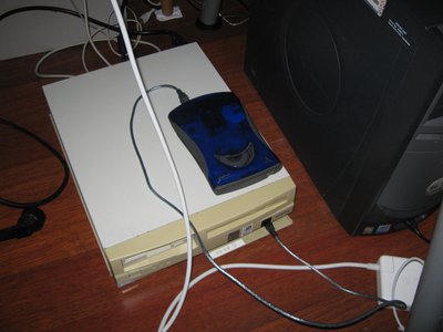

- Test MO drive with this computer.
The drive appears to be equally dead on the Epson, so either my SCSI-2 cable is bad or the 3.5" MO drive in the enclosure is. I might pop open the enclosure (and the computer) to see whether hooking up the drive directly to the internal connector of my SCSI interface card brings it to life, which would enable me to isolate the problem further (if it works -> bad external cable or enclosure cables, if it doesn't -> bad drive), but that's not for today.
Instead I got this set up for the first time 😁 :
157.73 KiB
846 views
From left to right: My step-down transformer for 100V devices with Yamaha 100V power supply plugged in, Yamaha MU10 sound module connected via serial cable and headphones plugged in, Epson NLX system. Background, left: my old Apple PowerBook G4 that sleeps under the desk 🤣 , middle: Gateway PII system (side), right: my leg and Dell P4 system.

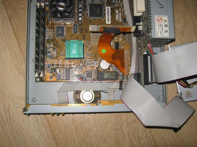

Horrible access to the CMOS battery requires removal of ISA/PCI cards, removing the plastic front of the case, cutting through the tape holding CD-ROM connector in place, removing said connector, sliding case section holding CD-ROM backwards and then up to remove it, removing floppy disk connectors, lifting case section holding hard disk and floppy disk out of case and folding it over to the side, and then folding the remaining cables out of the way just to access the battery:
328.28 KiB
769 views
Then, using a very small flathead screwdriver, wedge out the battery by pressing down on the tab holding it in place that is itself held in place with a rather strong spring, without accidentally stabbing screwdriver through thin and fragile CD-ROM cable that can't be moved out of the way because connector on mainboard won't budge and because the tab is very smooth and it's easy to slip away with the screwdriver while applying pressure.
Then reassemble the whole thing in the other order, making sure no cables get pinched and the floppy cables can still be connected back up and also applying some new tape to keep the CD-ROM connector in place.
Who the F*** at Asus thought this was a sensible design? 😵
