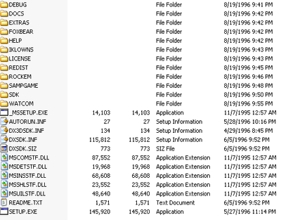

[EDIT2] regarding DirectX SDK 2.0:
it's available in "MSDN Disc October 1996" and compared to what was already posted here:
https://web.archive.org/web/20070513220912/ht … tX/DirectX3.zip
3 files are different (all other files are byte-by-byte identical):
README.TXT : "Beta 3" text is removed from the file and more details are added for folder content, i.e. it seems "Beta 3" was promoted to the Release version
DXSDK.SIZ : don't know what that files does, only one number is different, I believe it could be due to different size of README.TXT
DXSDK.INF : the difference is it just reflects the different size of README.TXT
So, basically "Beta 3" and the Release version of DX2.0 are the same. I am attaching the 3 different files from the MSDN disc plus screenshot.
    11.92 KiB
    554 views
    DX 2.0 MSDN Disc October 1996
